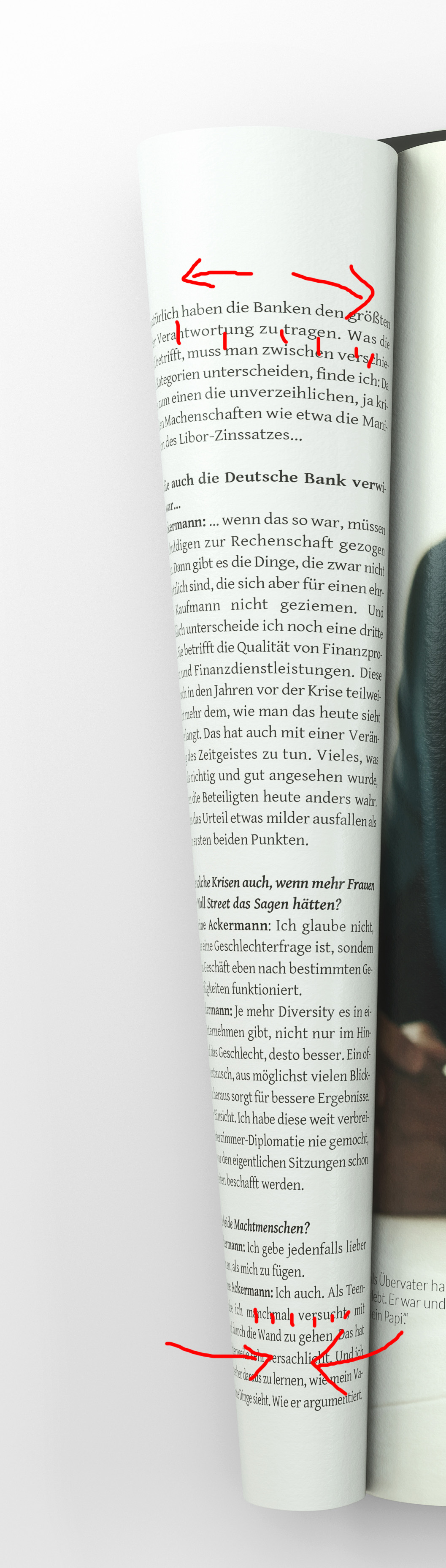

Can anyone tell me, how to achieve this kind of rolled
paper (which is also sheared) without distortion ot the text.
Its UV-mapped. Bending works well, but as soon as I want
to shear it, texture gets distorted as you can see in the Image.
How the hell do I do this?

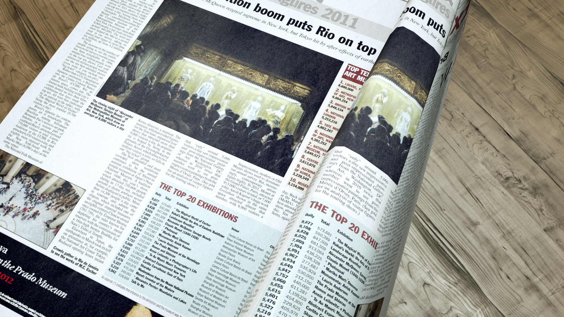

valters
Posts: 79
Joined: Sun Sep 07, 2014 3:18 pm
bend is making your paper like rubber. In my example I used loft to avoid this effect

thanks valters,
tried from SplineWrap to hundreds of Deformers,
but didn't get the idear with loft!
Thats working now.
You only have to make shure, that both splines of the
loft (when shaped) keep the same length.
