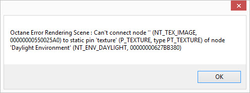

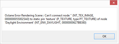

A related issue... Once I removed the texture file from one view, I got the error below. Thankfully no crash, just the error.
Also, do I understand correctly that all Revit views share the default render target setting (including the texture) unless a view has been saved to a render target?
Thanks,
Seeker
face_off
Posts: 15827
Location: Adelaide, Australia
Hi Seeker - is that error reproduced if you restart Revit and render that view again? If so, can you pls send me the file.
Correct.
Paul

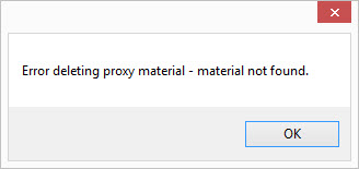

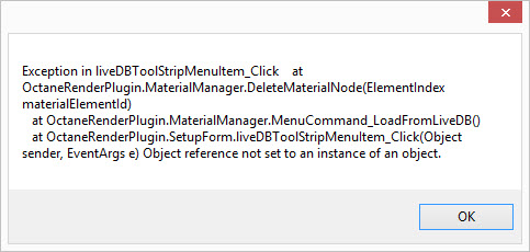

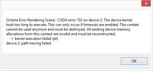

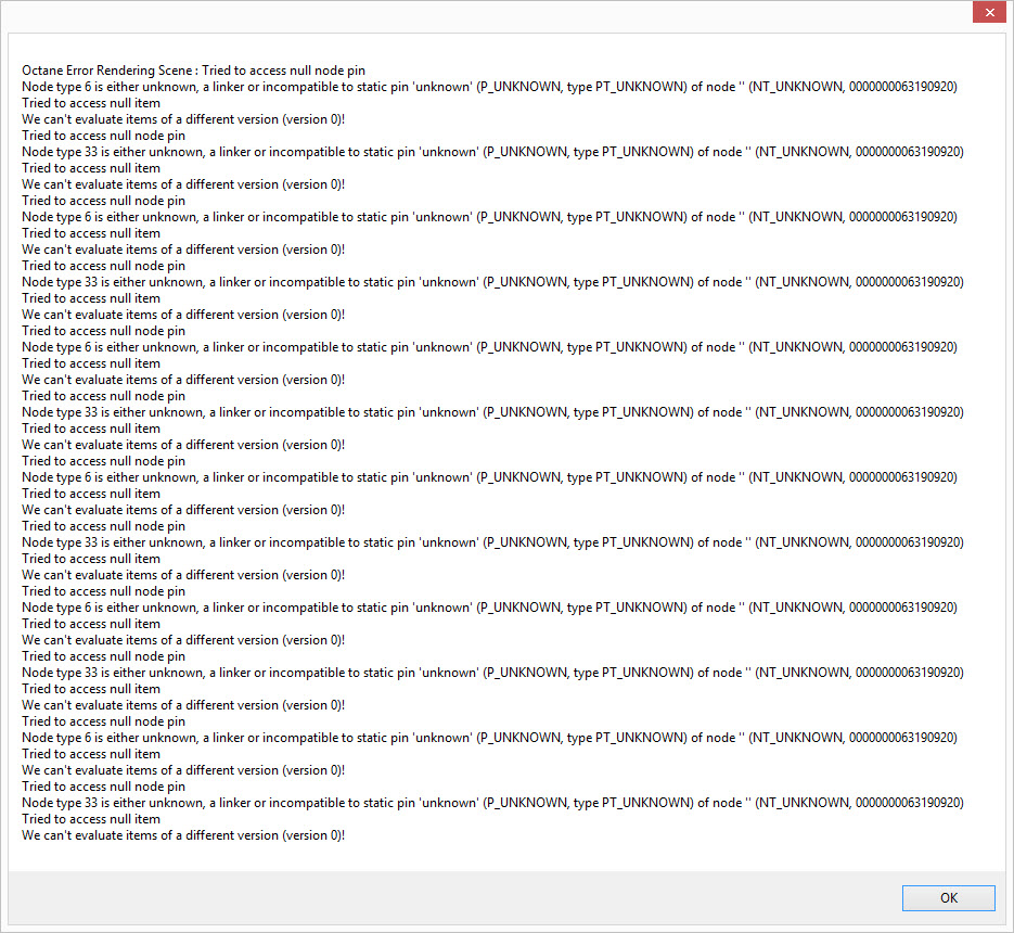

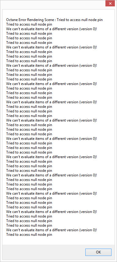

Hi Paul,
Below are those screenshots I was referring to. It's like they came all of a sudden without me particularly dong anything out of the ordinary.
Best,
Seeker
Error 1
Error 1
Error 2
Error 2
Error 3
Error 3
Error 4
Error 4
Error 5
Error 5

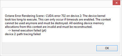

On the same model, I just got 2 'Nvidia driver has stopped working and has recovered' Windows notices and then the plugin error shown below. The renderer pauses but resumes upon acknowledging the error. It happened when switching to path tracing kernel. Using the latest Nvidia driver.
Best,
Seeker
face_off
Posts: 15827
Seeker - all the issues you posted above look like a problem where the installer has been able to update the plugin, but could not update the Octane API DLL (potentially Revit is still running, or still in memory). I suggest rebooting, then uninstalling the plugin via the Control Panel, then re-installing the latest version.
Paul
