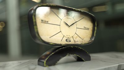

Not sure if this has been posted before, I did do a quick search and found nothing. Unless I'm doing something wrong, it seems Octane's DOF has a glaring issue: Reflected DOF does not render correctly.
Focus Point = Clockface
Clockface in focus but reflections are blurred

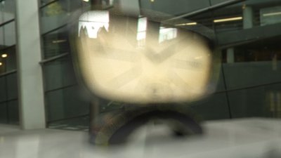

Focus Point = Backdrop
Clockface blurred but reflections over clockface are in focus!
What the Huh?..

Tbanks linvanchene and very well explained. I did the camera test myself (real camera not CG)
http://render.otoy.com/forum/viewtopic.php?f=23&t=42201
(i posted it in another forum section, double the embarrassment!)
