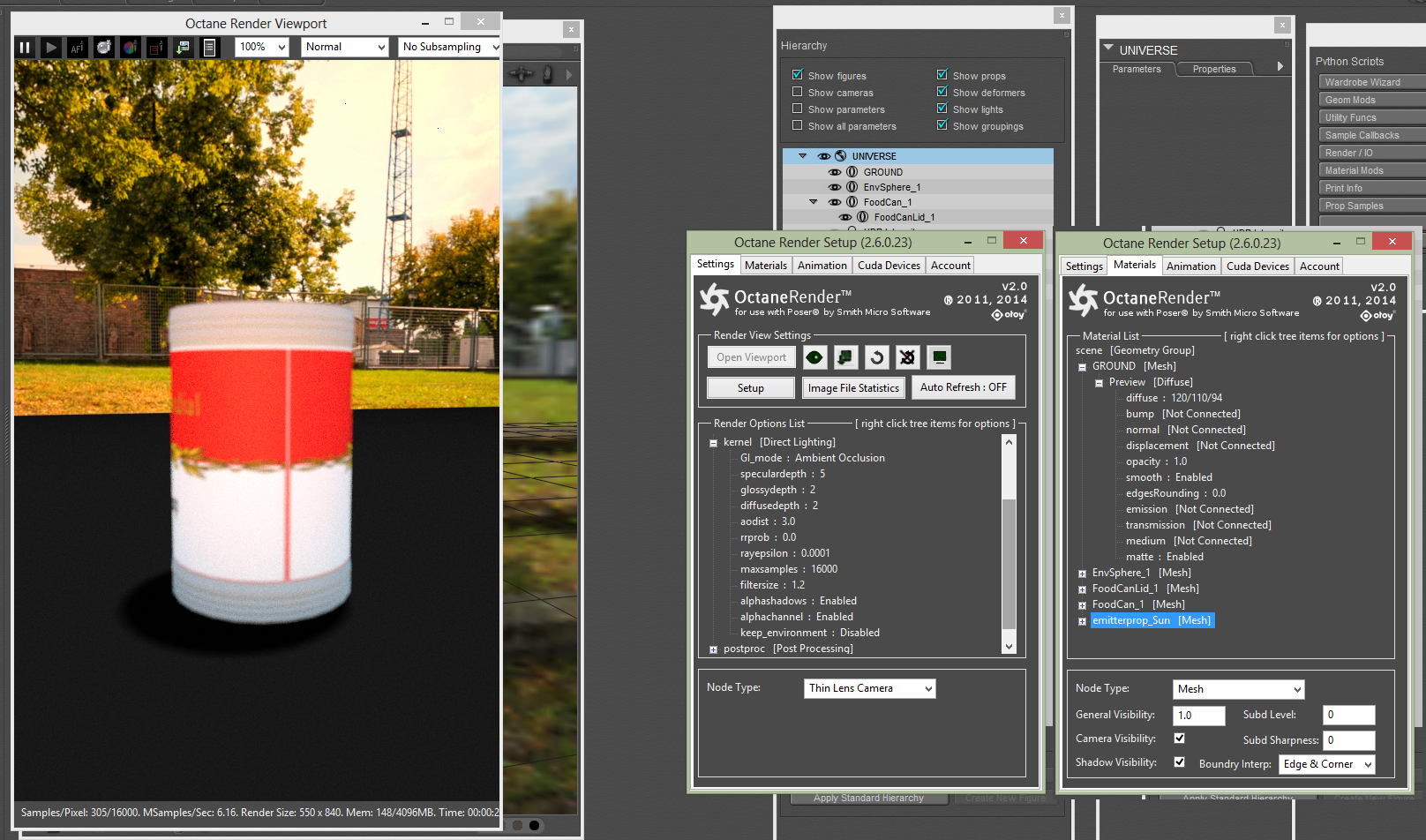

Hi, guys, thanks for the responses but that's exactly what I didn't want, I did read the manual. Maybe I'm missing something. Here's the resulting Octane render in a test following the manual as I could see it.

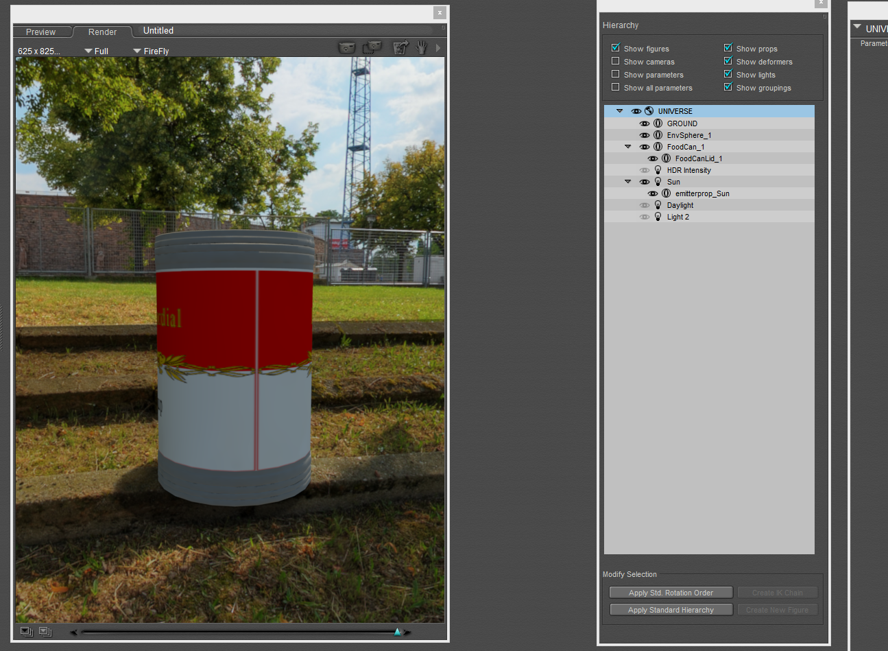

Ok, here's a Poser render doing what Poser can do, which is what I wanted all along....

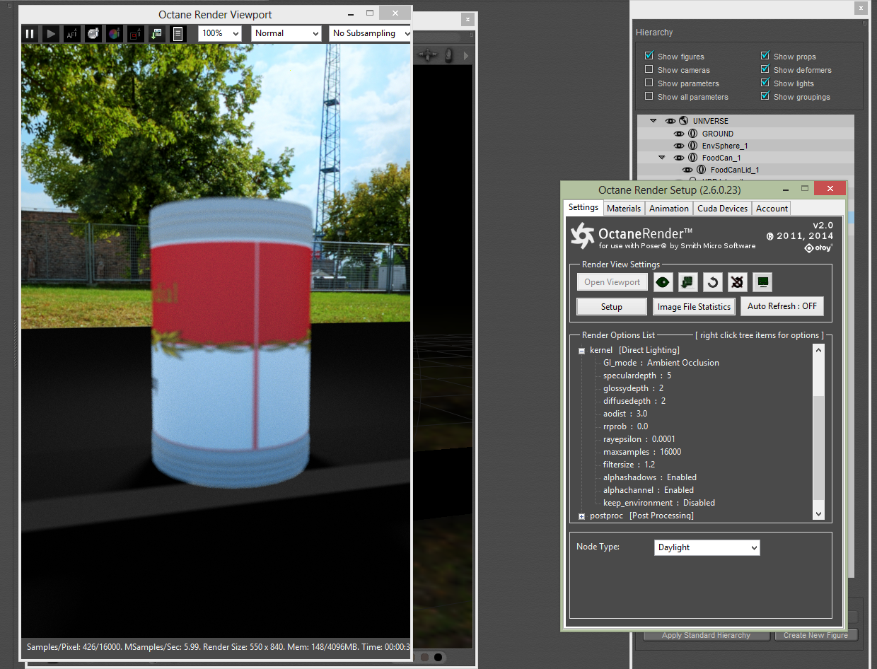

Here's octane again....

I've never used "matte" enabled with an Envirosphere - can cannot comment of that specific situation. The preferred way to handle this is to delete the envirosphere and sun props, and use a HDR map in the Octane "environment" texture. If using HDR or EXR (as opposed to jpg/png), set the gamma to 1, power to 1, and it should work well. You may or may not be able to use the envirosphere texturemap as the environment map - my guess is "not", unless the envirosphere geometry is UV mapped to a lat/long HDR map (which is unlikely).
