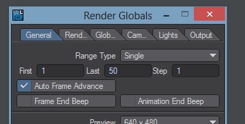

Attached you have an example about how to set the LW global settings to render an Octane animation from frame 1 to 50 ... as you can see is like render any LW animation, set the start and end frames and press F10
