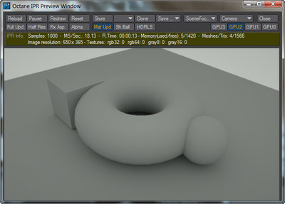

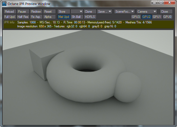

All items visible IPR tells me I'm getting 18.13 ms/sec.
Items Visible

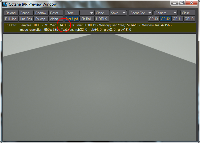

'Hiding' the objects using Object Dissolve @ 100%, now IPR says 14.96 ms/sec.
Hm...slower with invisible (100% dissolved) objects?
Items Invisible
Keeping these 3 items at 100% dissolve, now I also check 'unseen by camera' and Uncheck 'cast shadow'. IPR still says 14.96 ms/sec
Effectively it seems the scene renders slower if these items are set to 'invisible'!

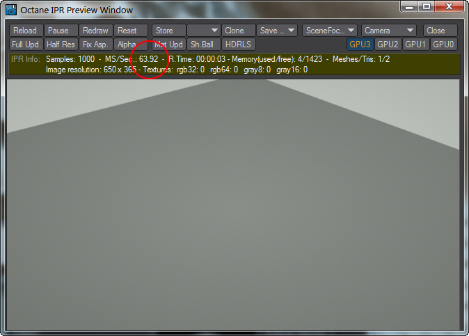

I want it faster not slower, that's the whole point of hiding objects when I don't need them. So this time I toggled the active state in the scene editor, and bingo- 63.92 ms/sec. Three and a half times faster which is what I'd expect since 3/4 of the items in my scene aren't being rendered.
Items Inactive
