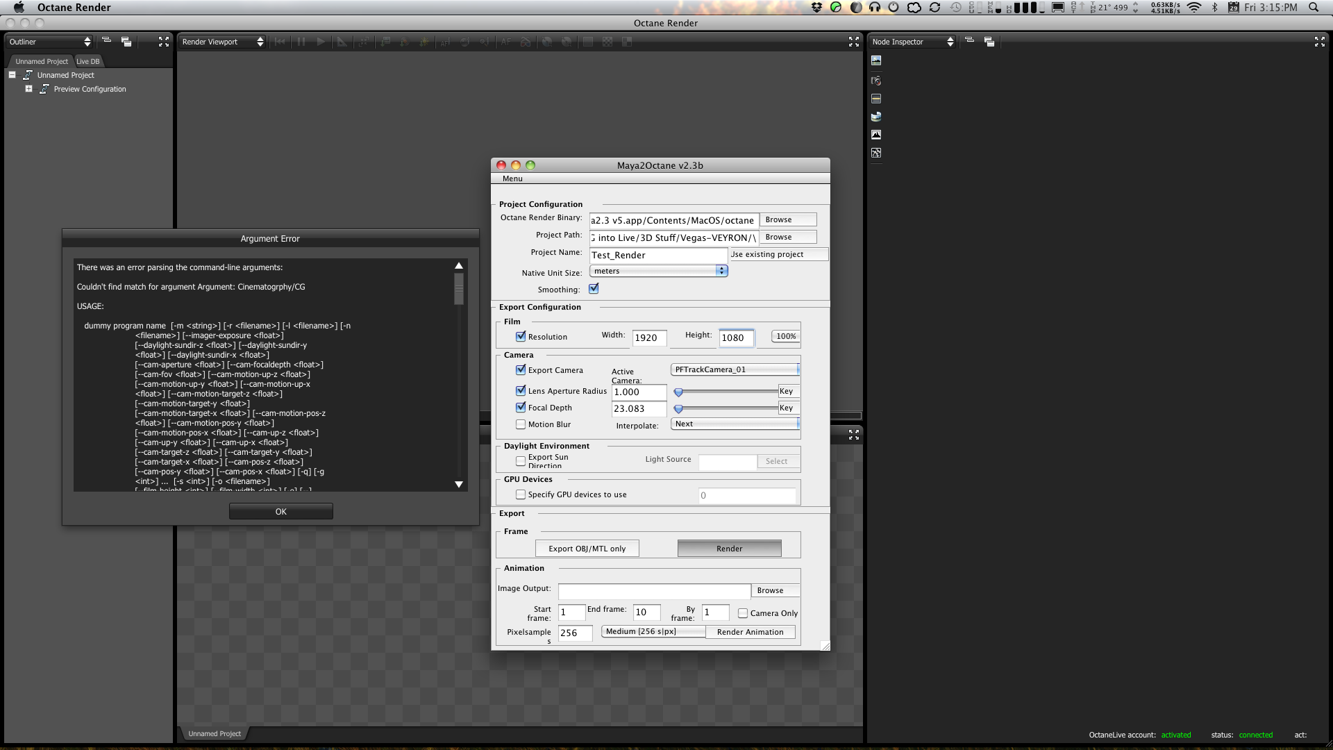

I made the project with PFtrack and then I imported my model into the project. I can send the model just fine into octane manualy, and it works. But I need to render an animation.
This is what I got from octane when I tried to send it our for render from mayas export script for octane.
There was an error parsing the command-line arguments:
Couldn't find match for argument Argument: Cinematogrphy/CG
And then all the file info with camera position and stuff.
if anyone need to see all of that Ill post it.
Anyone please help me,
Thanks!!

I still get the same error...
I was thinking it was my maya2octane script but I made a new maya project and a quick animation and it worked fine.....
Here is the whole error I get in octane along with the obj file that opens up, but doesnt use the pftrack camera.
is there any other way to render an animation from maya?
~Ben
Octane error and obj files.zip
(4.79 KiB) Downloaded 334 times

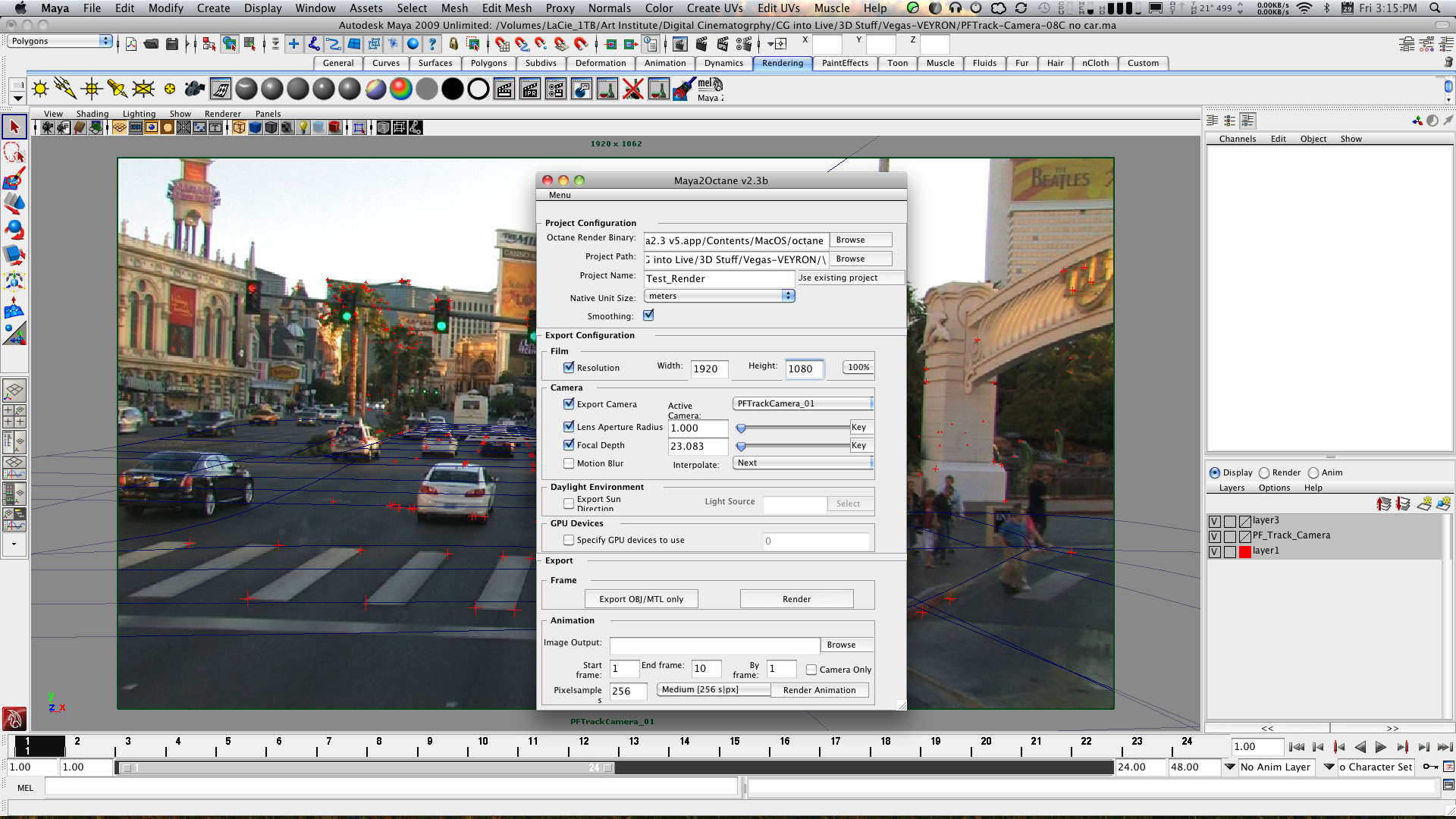

bendiger
Posts: 15
Joined: Sun Oct 24, 2010 10:03 pm
yes I made a simple animation with a ball, plane, camera and a few textures and it rendered using the script just fine.
Should I try reinstalling everything?
As for the script, when I loaded it onto a shelf through the script editor, it loaded just the script and none of the icons. Is that a sign that its not loaded properly?
If thats true, why can I render simple animations but not a PFtrack camera....
Here are a few screen shots of what my exporter look like when I go to render.
~Ben
