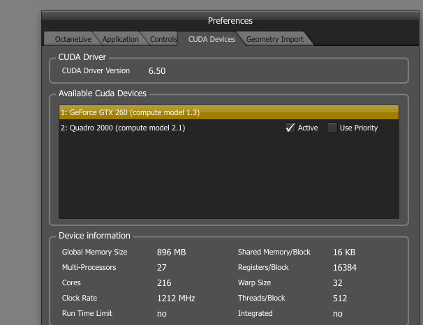

Need some help . Trying to set up gtx260 for octane and Quadro for screen .
Quadro working fine on screen and Octane but gtx260 not enabled . I've installed the latest drivers for both .
Working on version 1.51 . Want to set up before upgrading to 2
Any ideas would be appreciated .

hi,
"compute capability 1.3 which became unsupported in version 1.21 (and no PMC or matte material in 1.20)." - so what that means, is that if You wish to use Octane that has higher version You need new card =)
