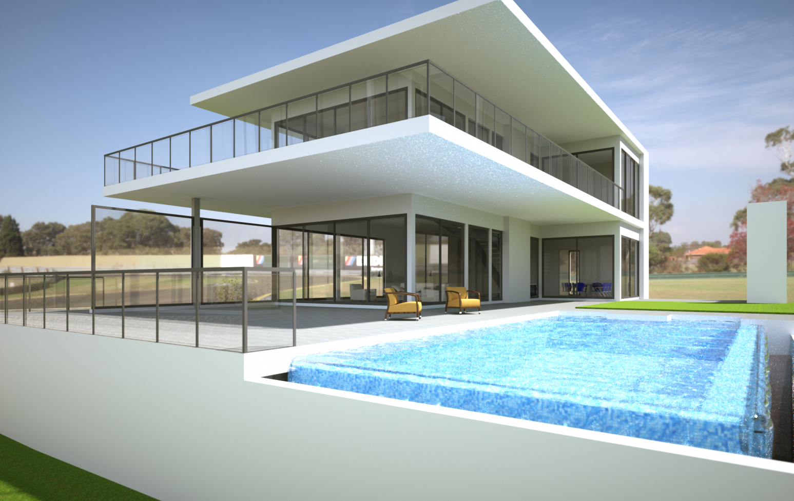

Hi I'm working in a image with a swimming pool, and I have a problem with the reflected caustics... How I can get a clean refletion of the caustics?
The water has a displacement map, and this image has reached more than 10000 samples. Any ideas?

maybe with PMC kernel.. it's more clean.I made some tests and works better!!

Set hot_pixel to 0. And try setting GI_clamp lower. And increase caustic_blur.

With PMC better but I little bit slow...

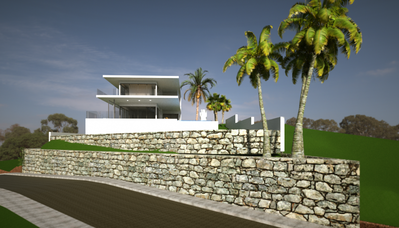

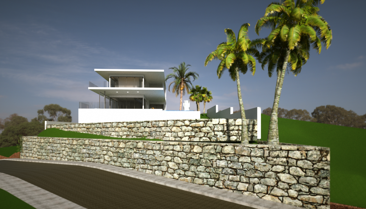

Have you considered putting that rock retaining wall texture into the displacement map pin?

Garquitectos wrote:With PMC better but I little bit slow...
Sure ...it´s slow but, with the same Smples/pxls more cleaner that pathtracing,(sobretodo con caustics y specular reflections)...another thing is...sorry if I´m wrong, for the moment you can´t use the "importance sampling check button" (it's a shame)in the HDRI map when you mix the octane sun system with a HDRI environment MAP.
