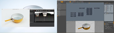

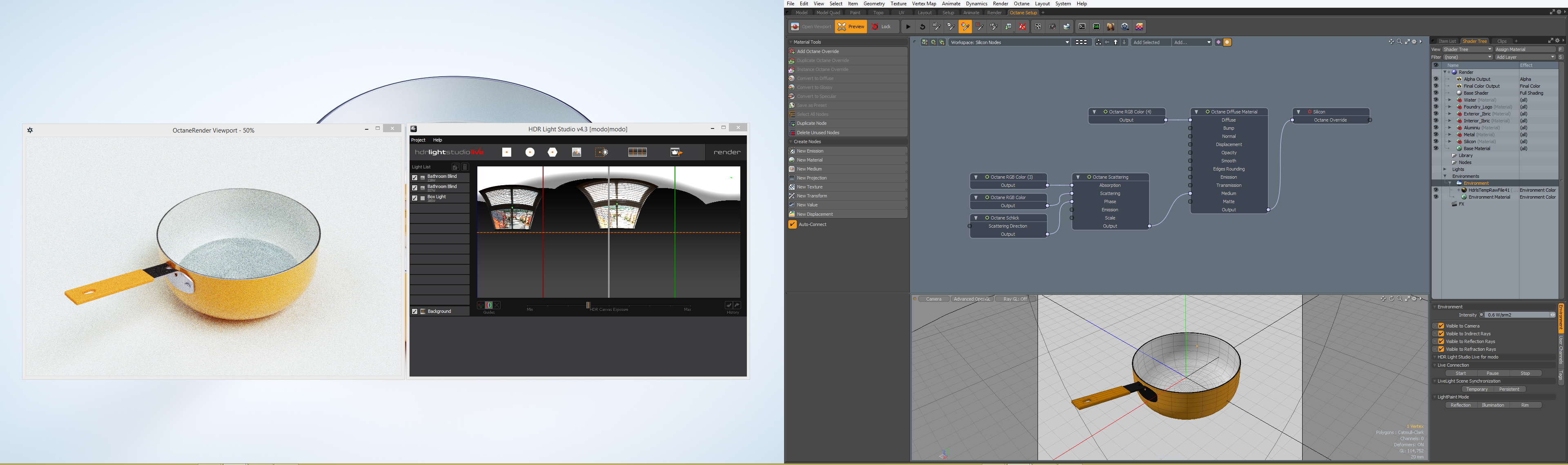

Hi Paul,
This is my idea, of the workflow today, letting me to use modo,octane, and hdr all in 2 monitors.
The main reason for this GUI setup is to not have windows overlapping. I use modo to setup the camera,
it is just more fluent for me, and with this setup I do have access to modo shader tree,images, etc withut
having to go back to modo from Octane Setup window.

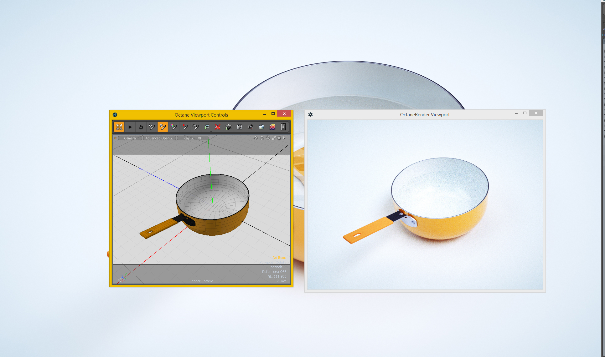

My request is to consider this setup and to insert it into the octane new layout. Also it would be nice to have the camera under the current viewport as seen in second image. I can not use this second setup now with modo viewport under those tools because it resize back and snaps to octane window frame.
Cheers,
Vlad

Hi Vlad - that looks like a great layout. I particularly like the Modo preview window in the Octane Viewport controls. However for people on a smaller single monitors it will not work. And Modo does not allow options in the UI (so I cannot add a tickbox "Add Modo Preview Window to Viewport Controls Layout" in the preferences).
Is it viable for you to simply customise the UI as you have done for your own purposes? You can pull out the XML from the Modo801.CFG and dd it to your own CFG file and store it in the OctaneRender For Modo Config folder. Then attached to your own Open Setup and Open Viewport buttons.
EDIT: The Linux version of Modo allows plugins to place a viewport inside Modo panel - so that is a huge step forward. I've been working hard to integrate this in the Linux version of the plugin. Perhaps at some stage this will be possible to do on the Windows and OSX versions of Modo. Suggest you let TheFoundry know that this is important for you - the more people how give this feedback, the more likely it will be pushed up their priority list.

Hi Paul,
I think it will work for 1 monitor too, or for small monitor the modo viewport window can be deleted, and having the octane render window over will work, in modo we can expand the viewport, with 0 on numpad, or hitting the maximize icon on the interface.
I think we can put this to vote, on forums.
I configured the layout as you see now, my problem is that when I want to edit one material, that is octane based, the octane setup pops up and my tab makes it usless. Can you make an optional layout with a switch button on the octane setup. I am not talking about aesthetics now, just utility, too many windows.
I think one tab inside modo interface as I have now on those images, with the open preview window, that will be just preview window, with all the buttons on the octane tab will be just great, since we will not have to hassle arround with overlapping windows.
When I need to edit octane material, modo materials and I use octane for render, I just go to the octane tab, I press open preview window and I check it.
I do not think current layout is better in any way for 1 single monitor, can we integrate octane setup window on modo tabs near reander as default?
Folks , lets vote, lets see if this works better for you too.
Thanks for help Paul, lets make it simpler, please.
Cheers,
Vlad
The reason for the pop is that Modo crashes if you add an Octane Override without the Schematic open. If there is no way in a Modo plugin to determine if the Schematic is actually open. So the solution it to open the Octane Setup layout (so the plugin can determine if the Setup layout is open, which it knows contains the Schematic). If the Schematic is in a panel or tab (rather than a popup), the plugin has no way to determine if the Schematic is actually open - so Modo may crash.
So, yes, I would love to incorporate your suggestions. However not at the risk of Modo crashing.
The current implementation is the most robust way I could implement the plugin. It is not perfect - but it is robust. I think to improve the plugin workflow from a UI perspective, it would need some improvements to the Modo API (which TheFoundry are providing all the time - so it will potentially possible in the future).
Sorry for putting a damper on your idea....it's just I have invested a lot of time getting the plugin to it's current state - and I need to be very careful to not regress.
