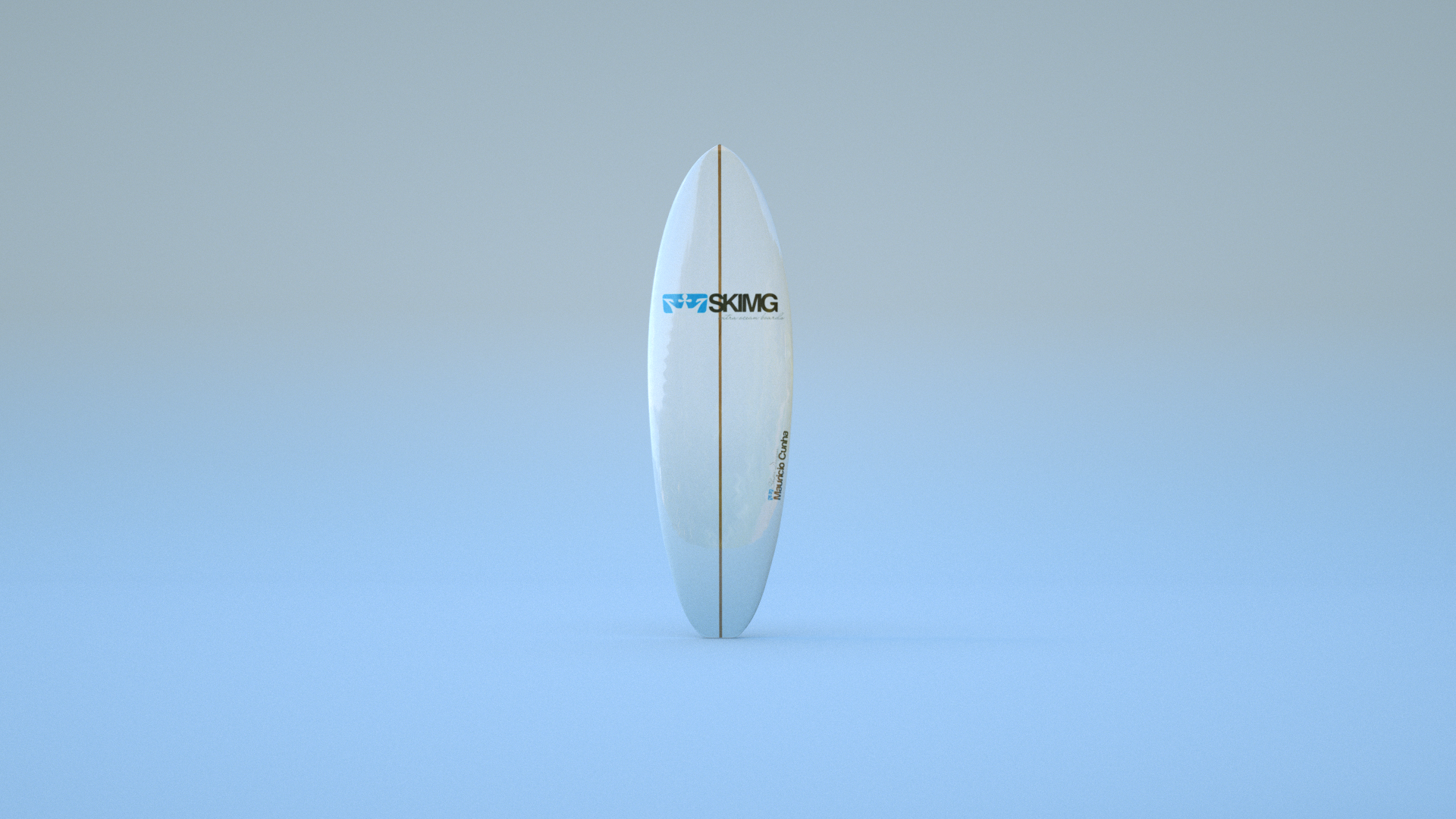

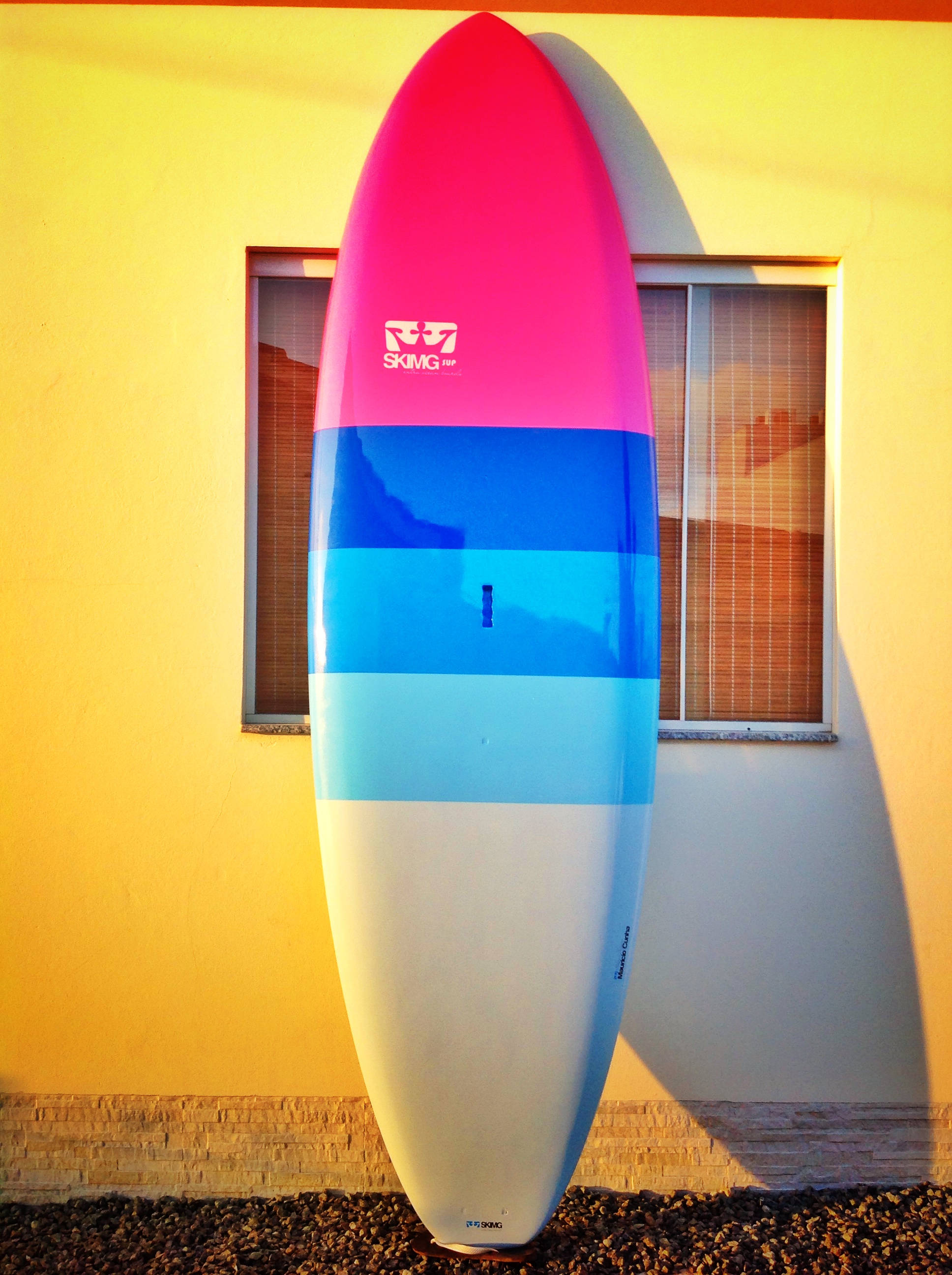

I'm having some difficulty to compose material like this:
And my result is this:
In this render i using only glossy material, but i try specular and glossy and others setups.

play with fallof, to get that freshener effect & be sure to have some nice HDR background to reflect =) otherwise in plain background You'll not see any effect. Simple glossy material should work just fine =) drop a line if You'll hit the wall..

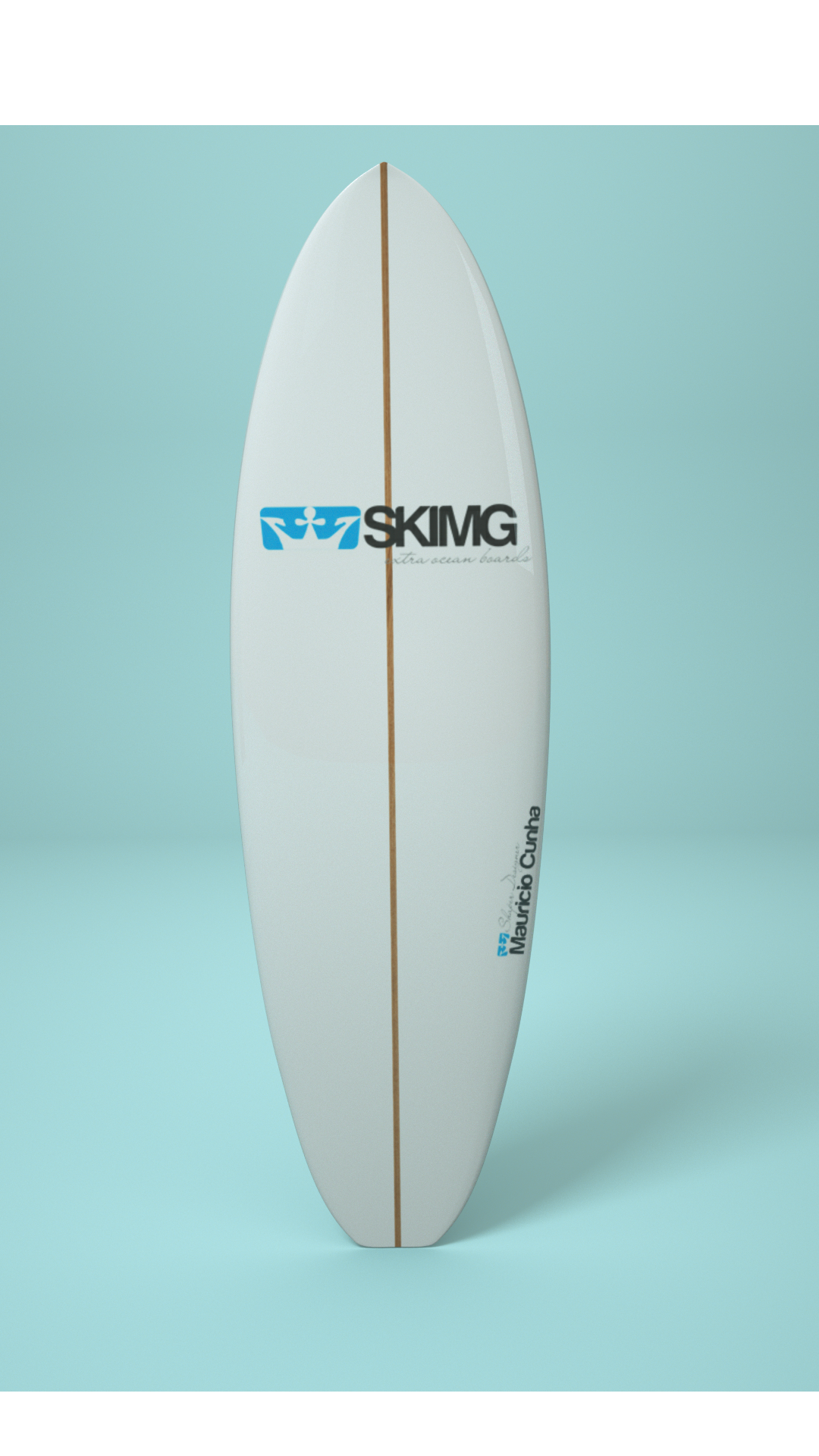

See the result now:
