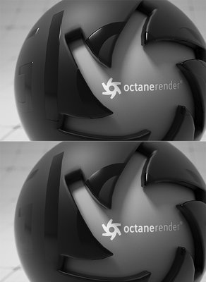

here's a very simple image sample of what i'm talking about.

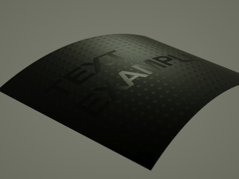

here is a example scene, hope this helps ;)
text example.zip
(208.74 KiB) Downloaded 253 times
the scene is for max 2013 and above

easy,
just use the texture file from my previous post and put it in the roughness slot (glossy material), make the diffuse slot a dark color.
i also used the same texture (inverted) to add bump.
let me know if you need any further help. :geek:

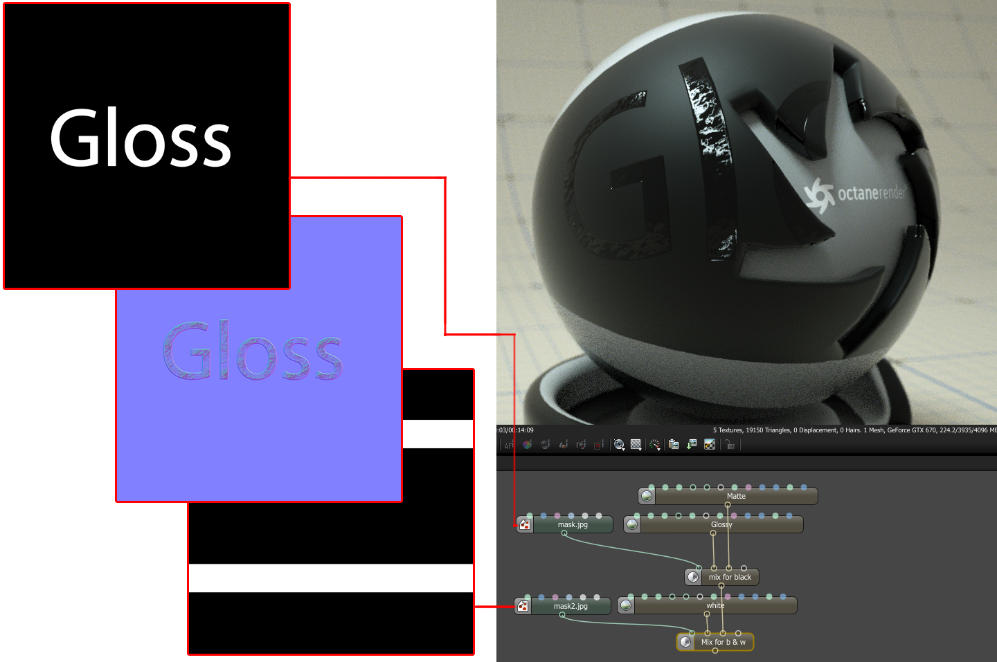

ghm,..don't know about maya, but it works perfectly in StandAlone:
two masks (one between glossy/matte blacks & other between black/white)
pluss a normal for some bumpy-ness (might be a bit too much =)

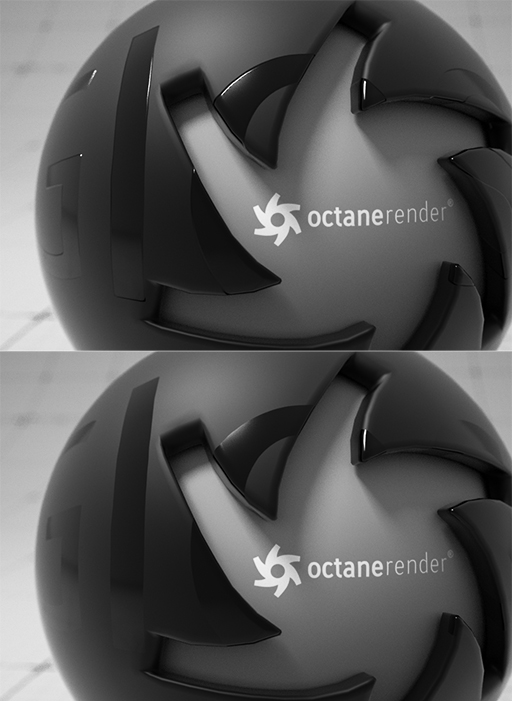

& that bump does a bit of a difference if You're looking to get desired effect, without it material isn't nearly as convincing, as You loose these reflections on the edges of pait -
here's the fast comparison without ripples =)
