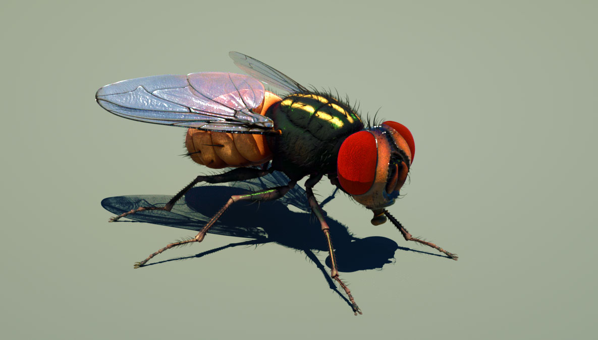

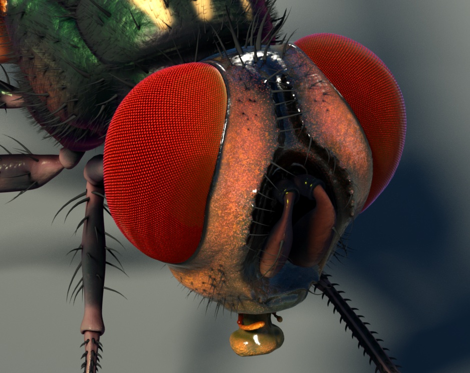

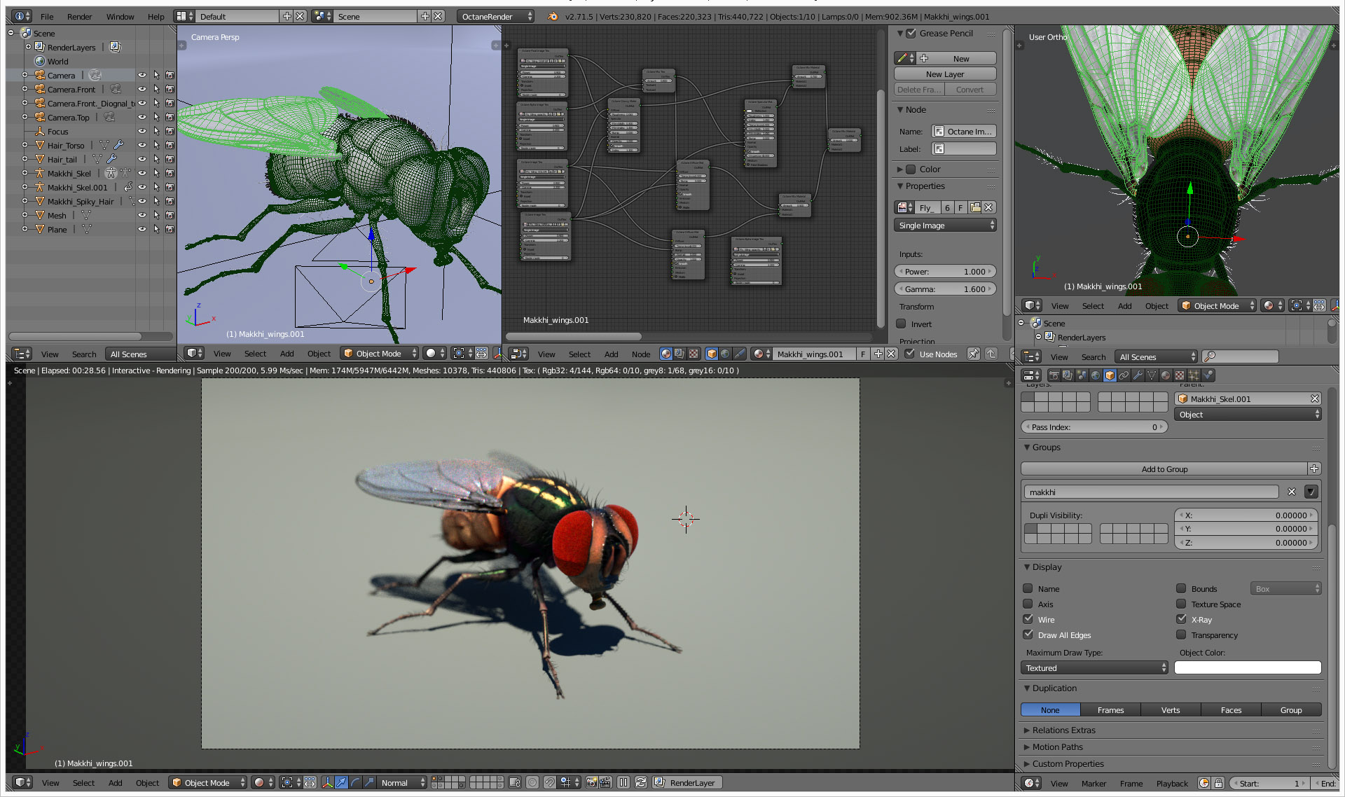

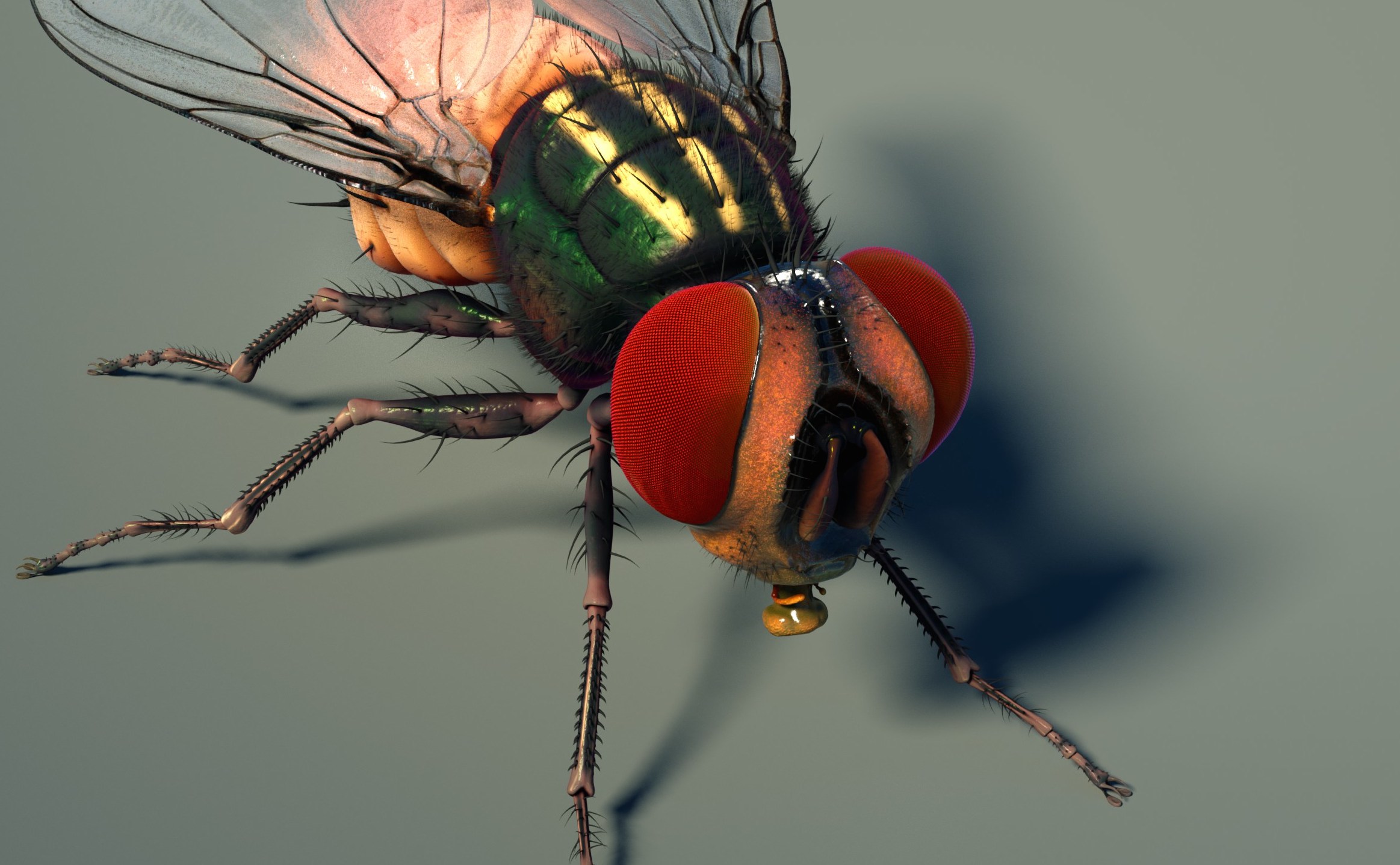

We have a new character in our Script. He is Kakaka the Fly. An extra terrestrial intrusion into the cartoon world.
We also wanted to test the new 2.0 Blender render engine. Wow we are loving it, and JimStar has done an excellent Job.
