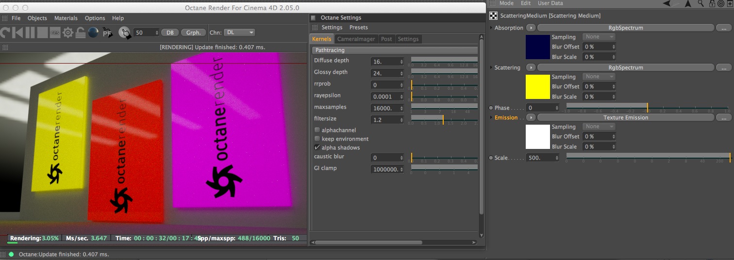

hi,
you can use a specular material with sss+emission in the medium channel ;)
here is a quick example, play with the SSS scale for balancing the emission:
Specular-light.zip
(365.4 KiB) Downloaded 258 times
ciao beppe
