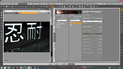

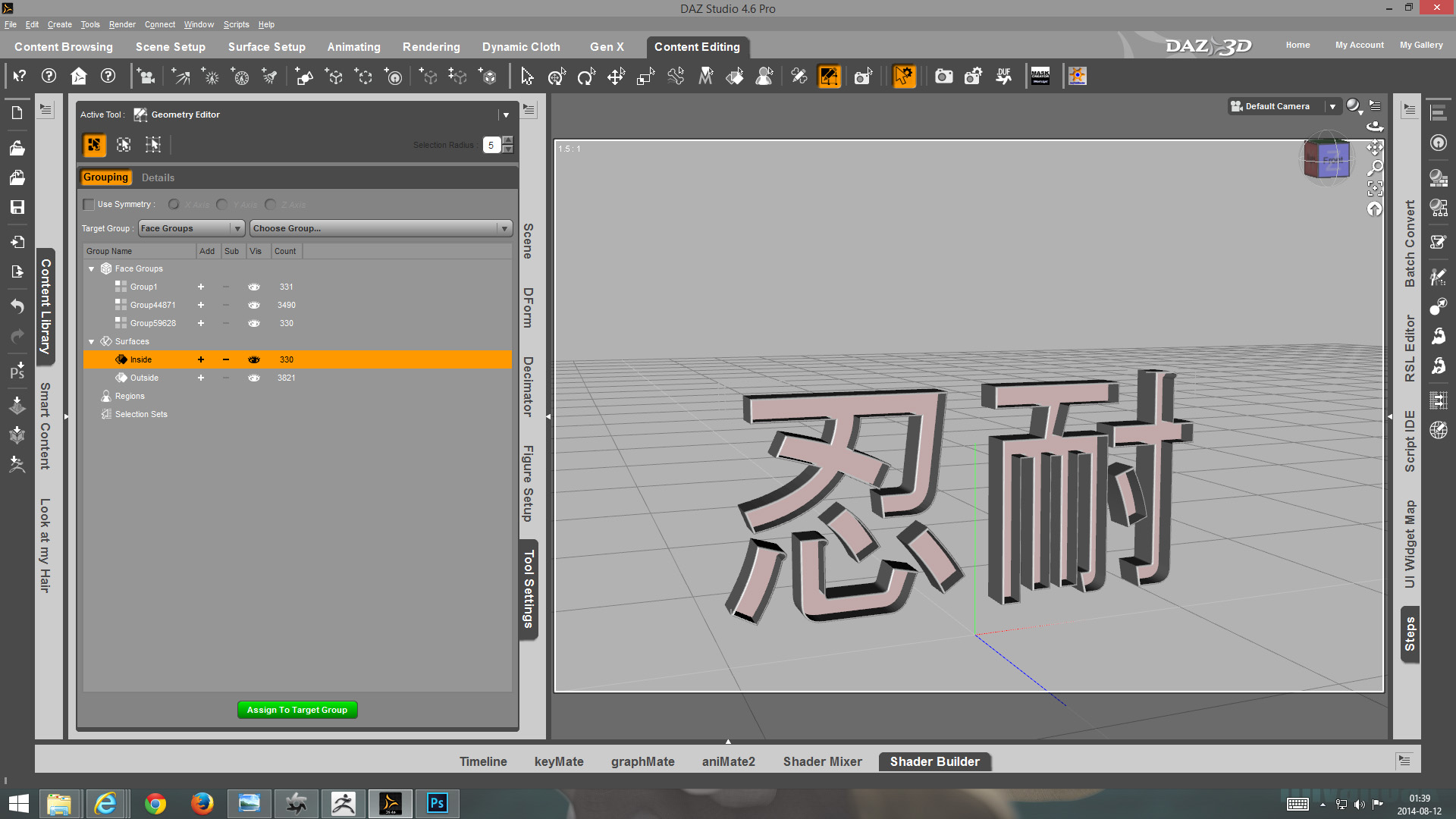

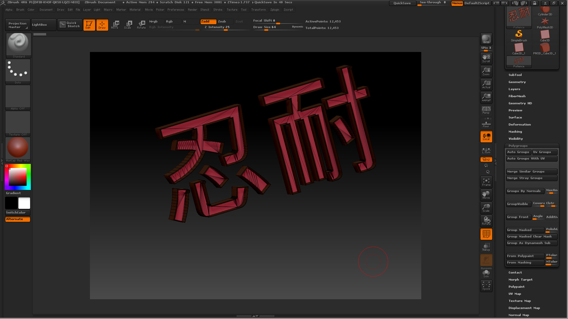

When using GoZ from Zbrush to DAZ Studio my basic workflow is:
- Set up polygroups in Zbrush
In this simple example there are only two polygroups. Inside and Outside.
- export to DAZ Studio with GoZ
- The Zbrush Polygroups show up as "facegroups" when using the DAZ Studio Geometry Editor
- Assign the "facegroups" to "surfaces"
- The newly created surfaces show up in the OctaneRender plugin surface tab
- Now you can assign a OctaneRender material to each surface of the object
In any case I would also welcome an OctaneRender plugin for Zbrush.
