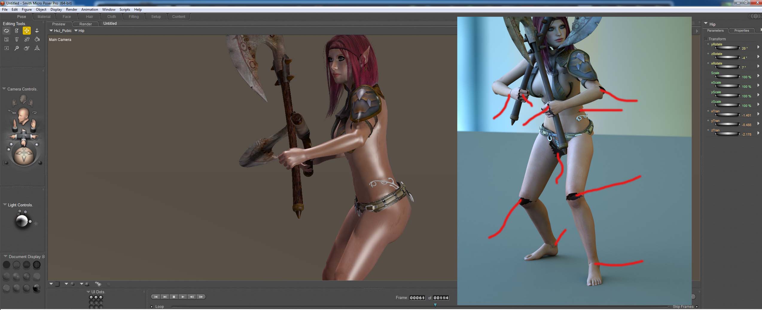

Okay I'm using the following at the moment Poser pro 2014 game dev with the latest version of octane render
So I decided to try one bit of the functionality in the new version.
To export out FBX Files. And import them into 3ds Max and motion builder.
Everything looks great within 3-D studio Max and motion builder,
When import back into Poser it all looks fine when rendering the firefly still looks okay.
But when you use octane render. See the below display.
Victoria has massive gaps in the geometry.
So I'm just guessing that logic tells me? If it displays impose firefly fine,
also in motion builder and also in 3-D studio Max. Then the problem lies with octane render?
Hi Chopper - it looks like Poser is supplying Octane with vertices which have not had morphs applied. Do you have Reality3 installed? If so, uninstall it and try loading and rendering your scene again - they may fix it.

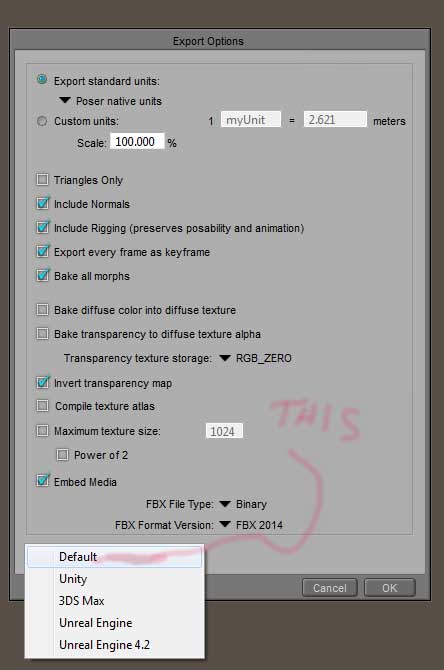

here are the default setings i use
also i tried all the skinning methods (none of them work)
V.4.2 IS THE MODEL

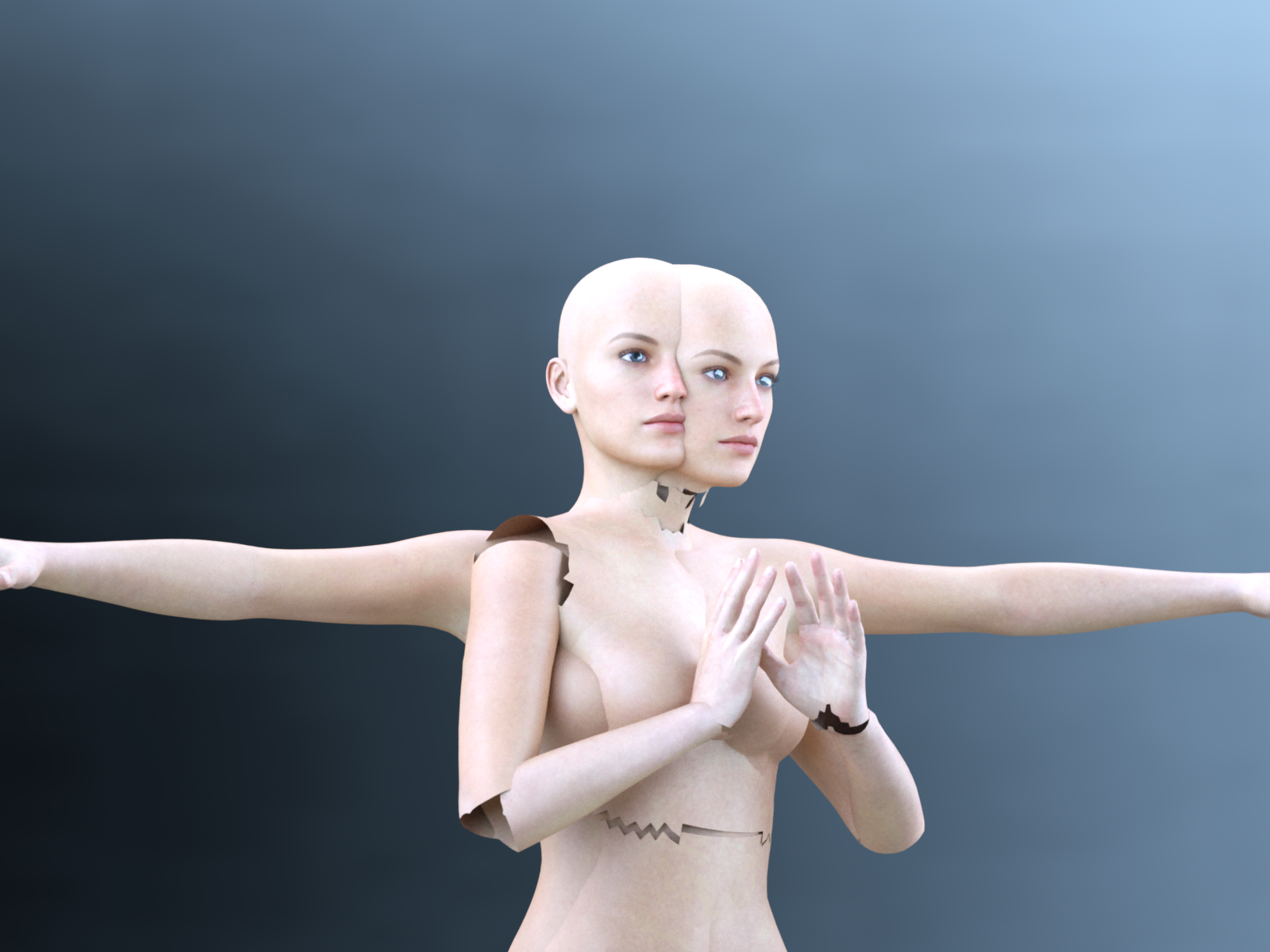

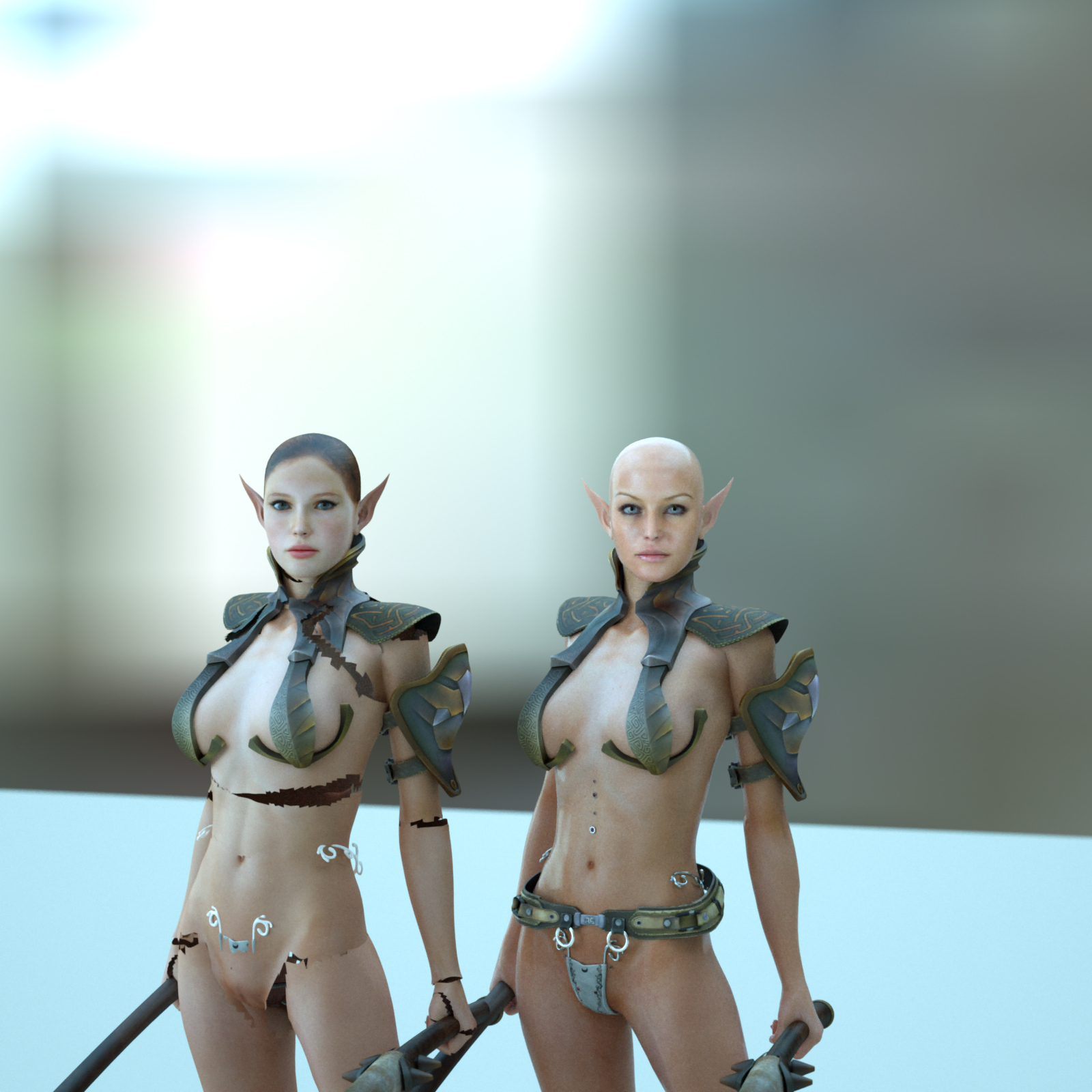

this also happens with SUM genesis daz3d characters.
but the bug is not as bad
there seams to be ghosting issue with genesis female characters. and other two
when you import the FBX file back into poser you will get x2 characters
see the the below pic
any attempt to remove or delete one characters removes both (this bug is in poser and octane
