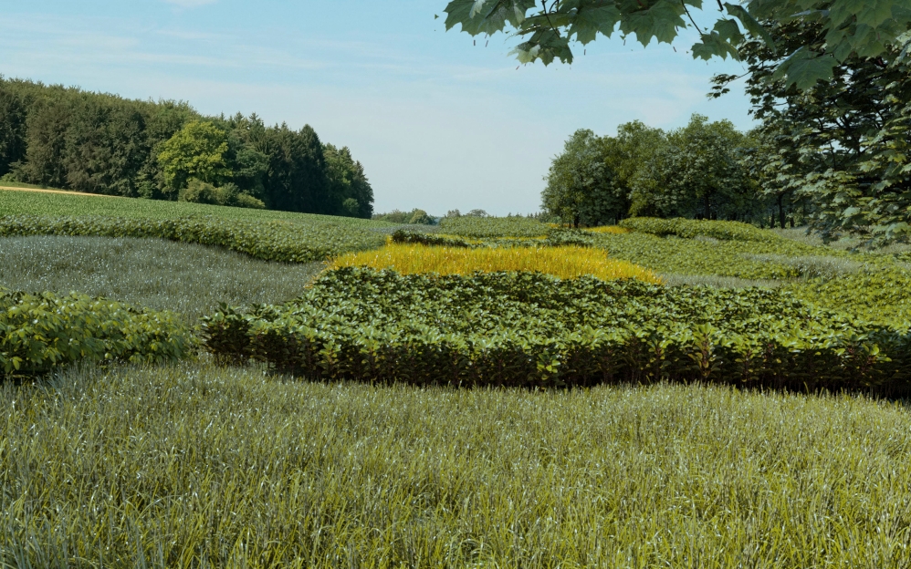

Other than that backdrop matching works like a charme in Octane...I just adapt colors/specularity etc. of the separate render elements to the backdrop and render away. Lighting turns always out to be pretty much the real thing because of path tracing. It is quite nice to recreate places and POVs that I see every day.
Render
Backdrop (just overlayed without any composite effects :)

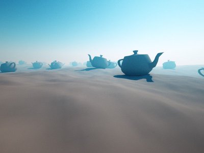

Hi, If it can be useful, explaned the method I use for fog and God rays here :
http://render.otoy.com/forum/viewtopic.php?f=9&t=38645

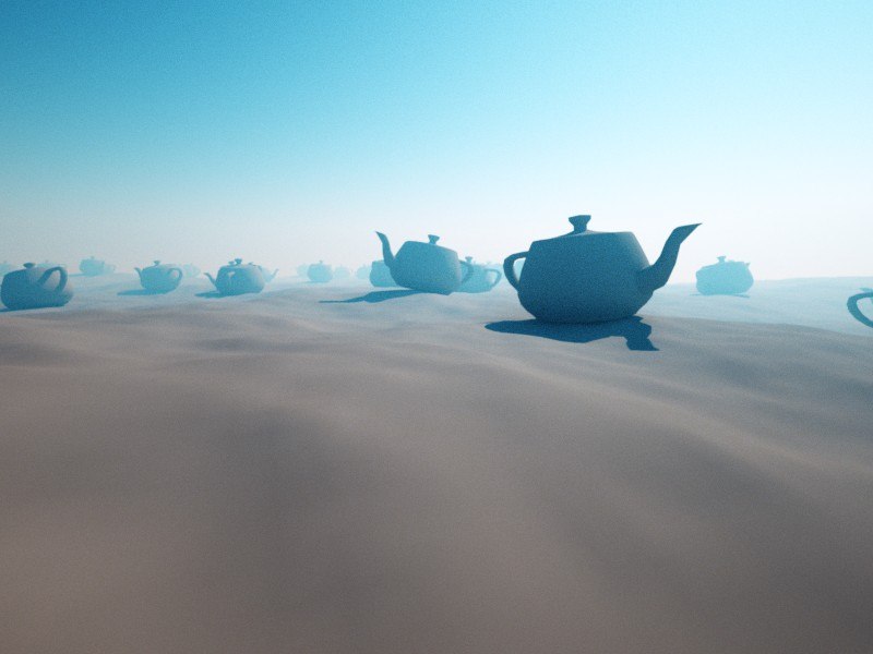

fog
BlueFog.zip
(1.04 MiB) Downloaded 226 times

I rendered z-depth and used it in composite. It worked well, even with z-depth only 100 samples. I think any other Shader based software does it also that way, i.e. adjust brightness and saturation by using z-depth. Personally I am quite happy with that. It works.
Also in general I have to say that Octane does a really good job in photo-matched landscape rendering. Scenes just keep coming and coming, all with photoreal quality if colors of trees/plants/etc. are properly matched. Lighting is spot on.
