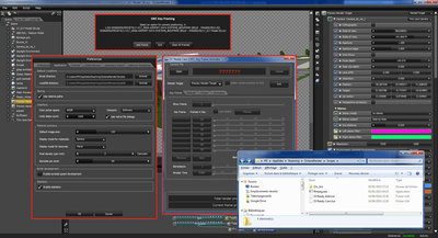

hi, happy new year 2015
I just installed the application to create animations( it's fantastic)
I have some problem with "standalone octane 2.15" it not working
1) Alt + R and Alt + A does not work
2) .orc file is added to the queue area camera
can you help me
can you help me
