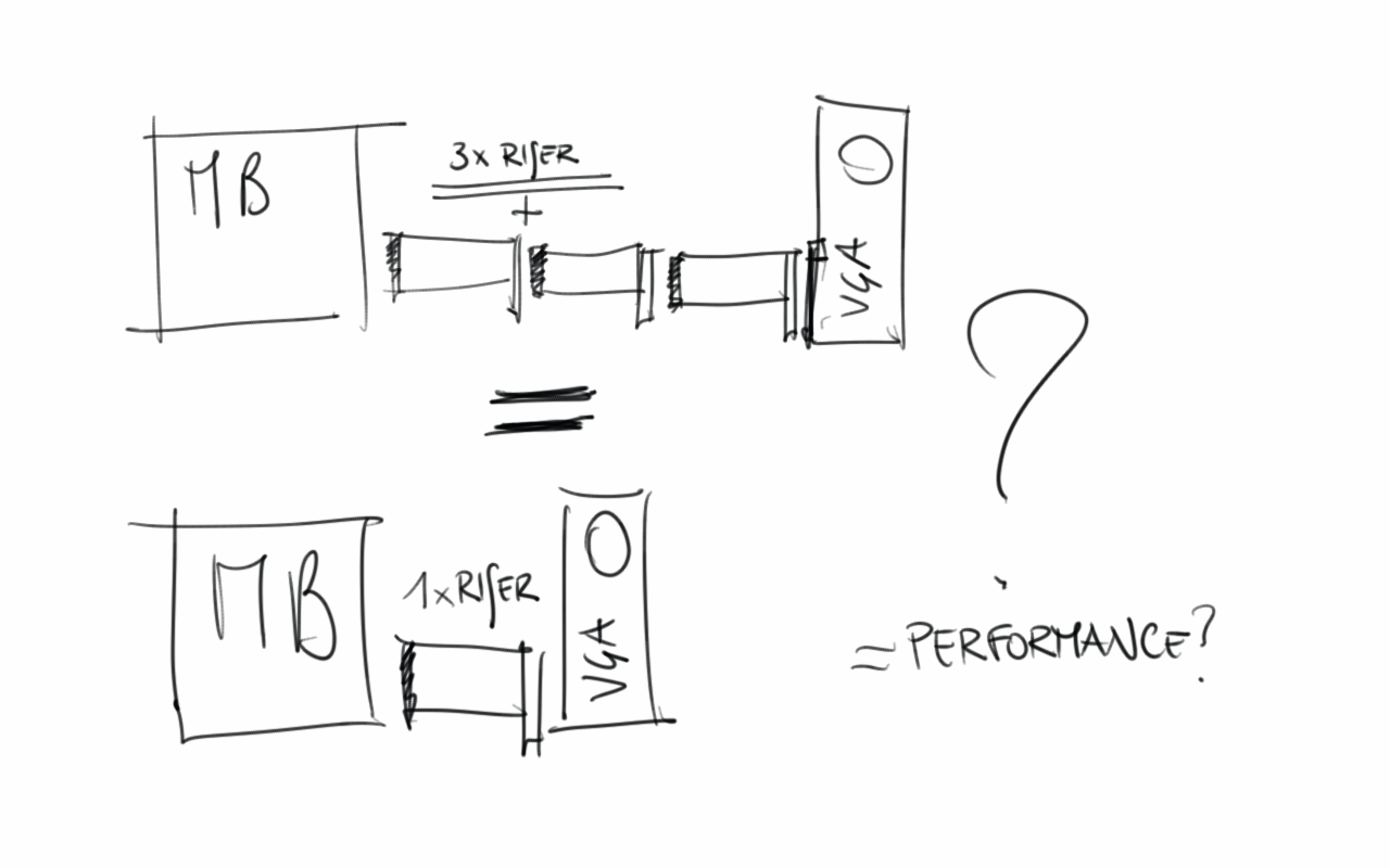

About performance is The same 1x riser or 3x riser? (See image)
What do you think about?

I'm not sure about performance but consider that you'll need 3 free molex connections to power up those risers.
Don't even think of connecting high speed GPU via not powered riser - it will just leave you with faults.
