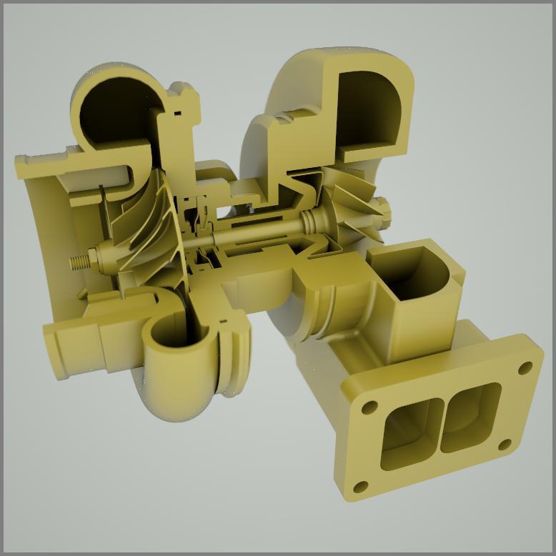

Here's an early experiment.
This model originally was saved out from Solidworks as vrml.
Actually each bit was supposed to have a different material ex Blender but for some reason I havent worked out yet the mesh imported as one blue one and not 15 coloured parts no matter what I did.
If any one can tell me why that is I would be grateful.
Got to be a setting or something... :)

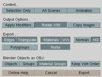

Using the same basic setup (Blender 2.49b, Octane 0.8a '9000.exe', XP-64) I exported 4 cubes and a plane with different materials (the file is attached if you want to try it) ... all seemed to work fine.
The OBJ export settings I used for this simple scene are also attached (they would be a bit different for the average scene, with modifiers or textures). If you want to, feel free to post a VRML file exported from SolidWorks, and I'll see what I get pushing that through Blender to Octane as well.

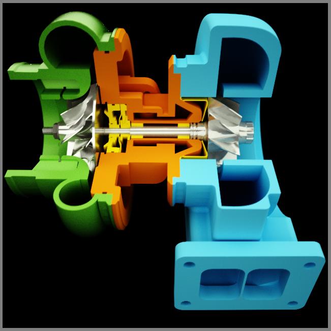

Found it! :D
my file name contained spaces - Octane didnt find the mtl :?
ok I know now confirm colour is available in unbiased renders.
I provide a hideous render to prove it.
I am an alpha state renderer myself.
