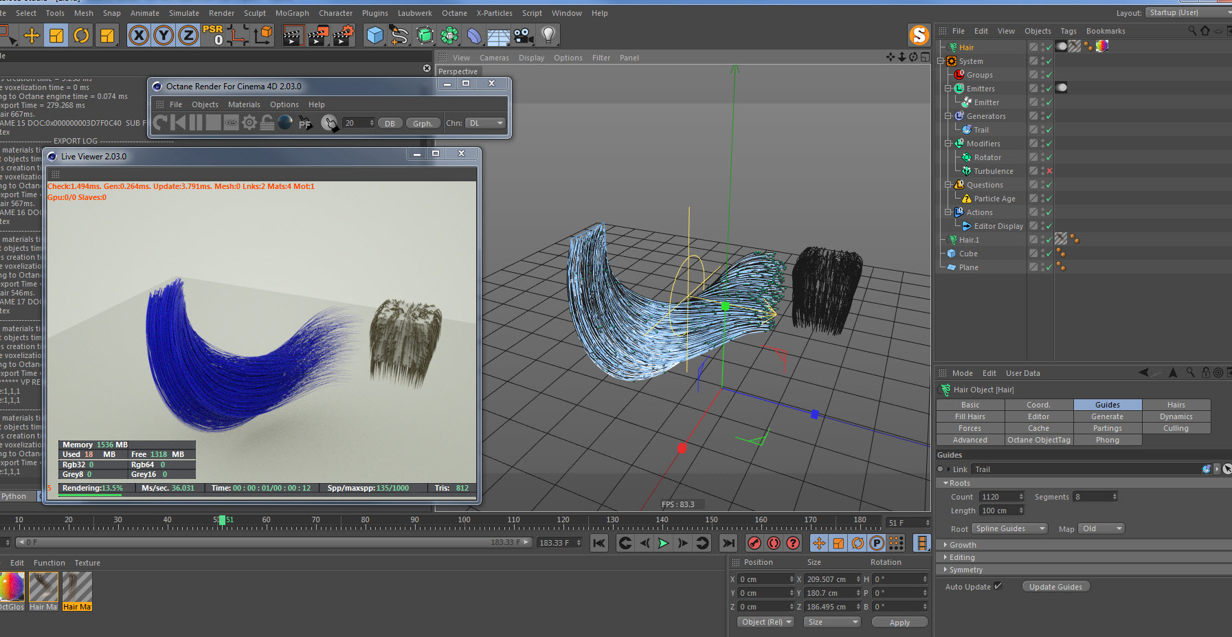

Hey, yea this threw me a bit when I was first playing with it but the solution is pretty simple.
Pretty much how you have set it up, then in the hair object > Hair guides change the 'root' to spline guides and up the point count until happy.
I posted a demo scene at the bottom of this thread...
http://render.otoy.com/forum/viewtopic.php?f=30&t=41177

This setup generates some hairs. But it seems not stabile, need some work to get real support for this
