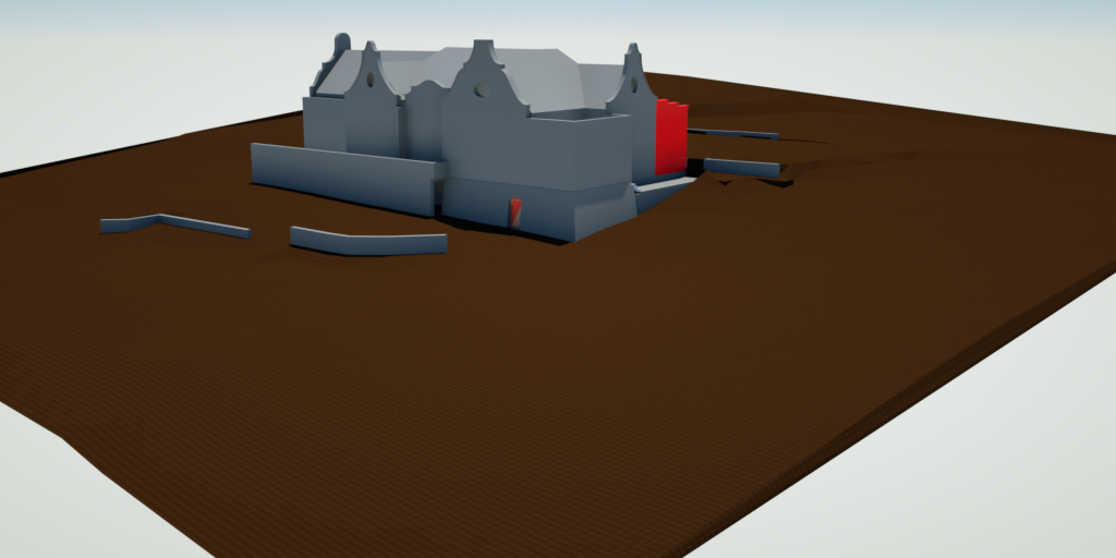

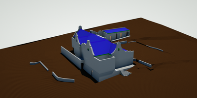

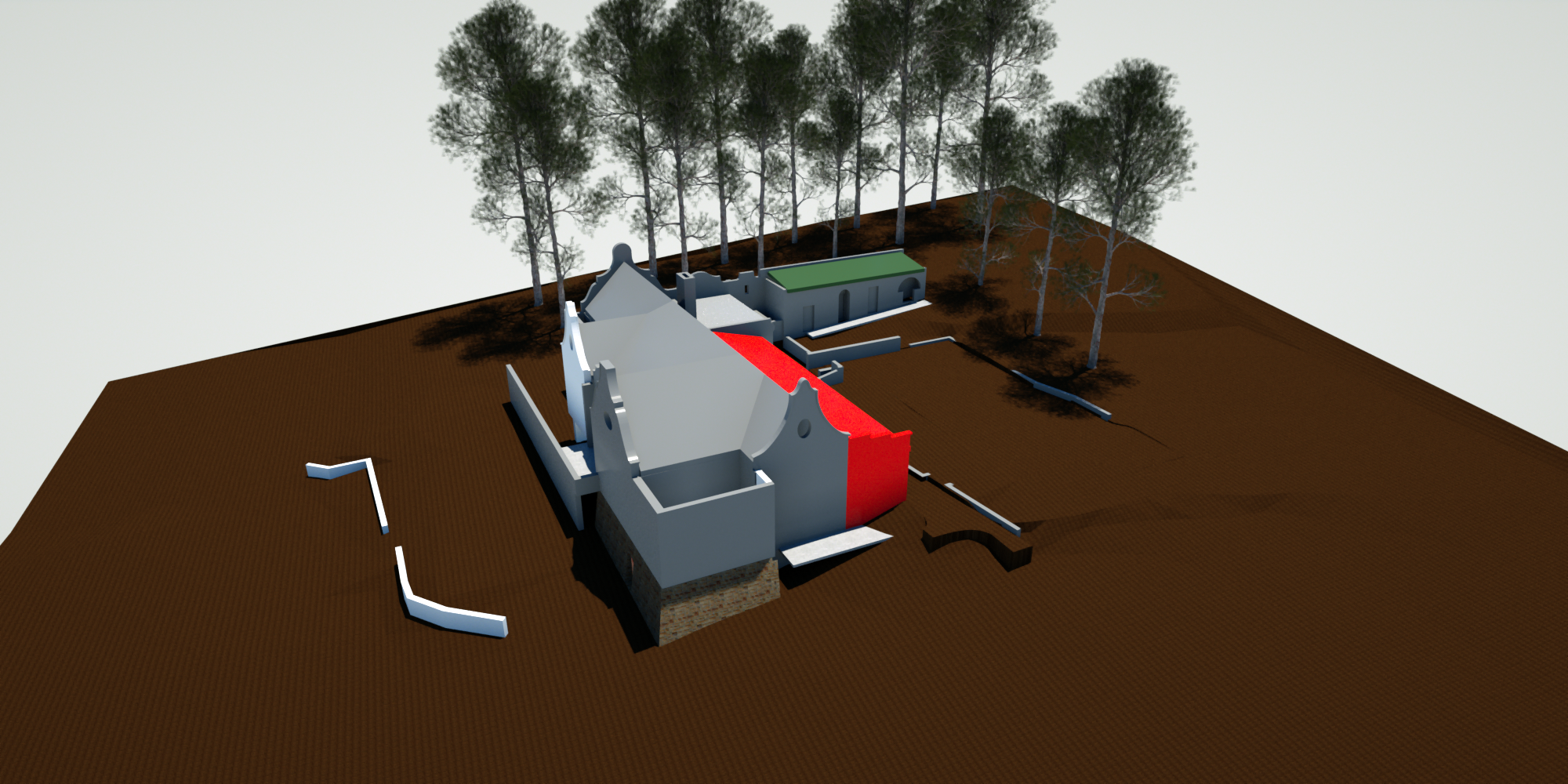

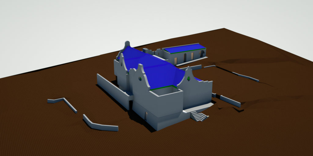

I never got round to sending you the previous project file, partly because it was so bit but also, since I was under pressure I just re-textured the model (thankfully only external textures). But I got the same problem with a new project today. All materials as well as proxy info and camera settings were lost. I can't pin-point an exact activity when this occurred these occasions but opening another Revit file when the plugin was running with an open render-view (causing the plugin to shut down abruptly) was true in both cases. But while this seems to be a possible cause, I know there have been times when I opened another file in the same fashion and then simply re-opened the plugin and everything was still fine.
Interesting thing is that opening the plugin again sometime later included some materials from Revit like it normally does when opening the plugin the first time for a project - i.e. not all the same gray material (except the site) (see below). I had only just started texturing and assigning proxies when this occurred so it may not look like much is missing but my precious stone wall is lost as well as the proxies as you can see.

What it looked like one moment... (I had only started texturing)
What it looked like after Revit closed the plugin due to another rvt file being opened - proxies & textures gone
And what it looked like after working on the project a bit more (?!) - some original Revit textures showing up again
