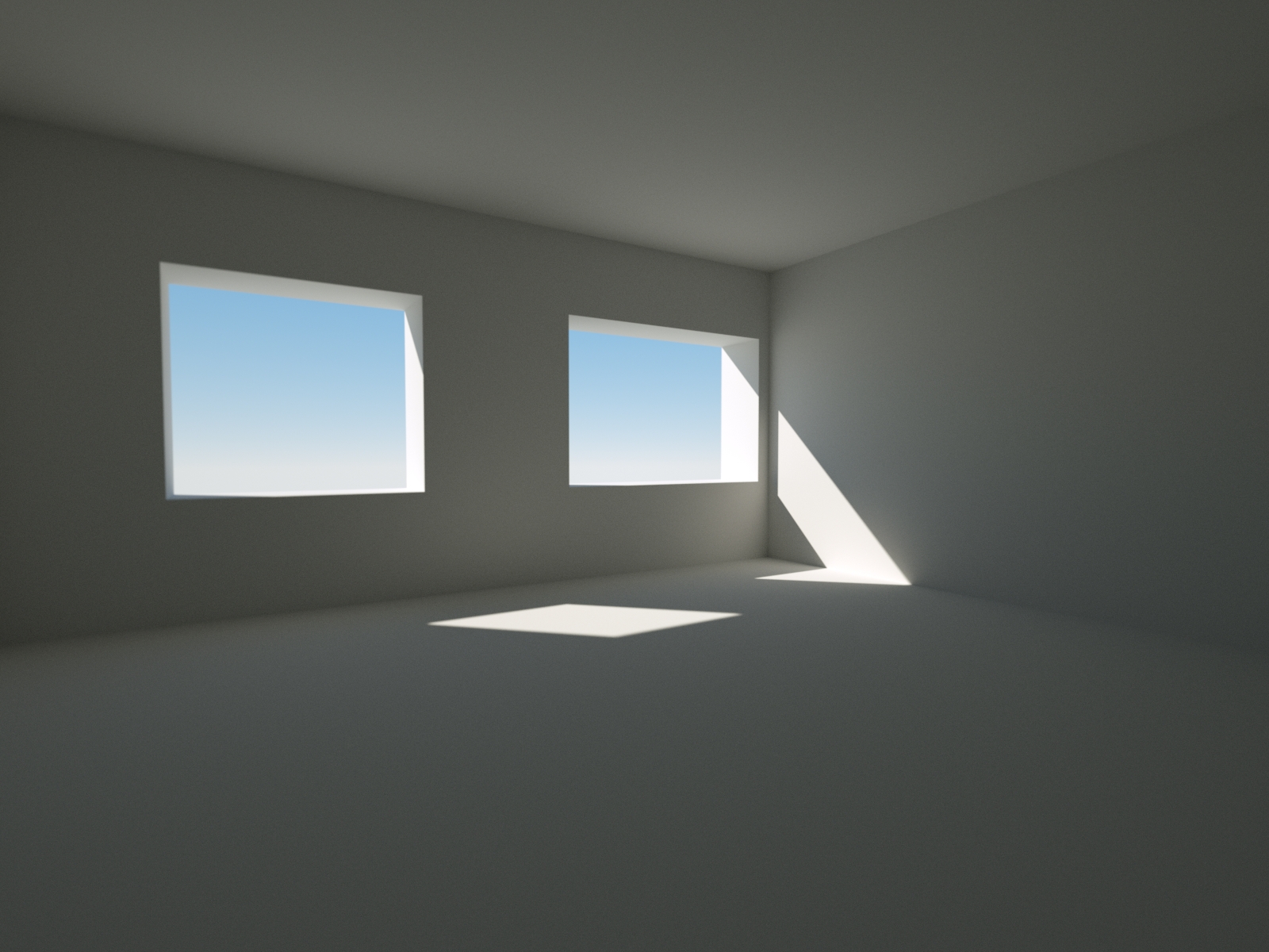

I made some tests.
Same scene one with default diffuse (DD) and one without material assigned (NM)
Diffuse : DD=49s / NM=44s
PMC depth 4: DD=54s / NM=50s
PMC depth 12: DD=2mn13 / NM=1mn55
renders are EXACTLY the same for DD and NM (open and compared in photoshop)
so ?
