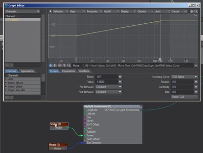

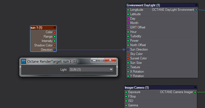

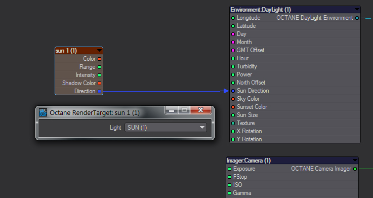

If you're used to working with lightwave lights (suns) ie: looking 'through' the light and positioning/keyframing interactively you can use a Light Info node connected to the Sun Direction. Minor niggle every time you reposition your sun in LW you need to frame-step to see it update in Octane, fast when you get used to it tho..

Oh, that's a good trick
