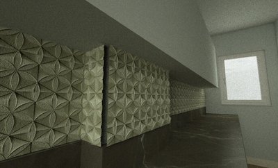

Hello... I'm trying to use the new feature of displacement ... But this is what I get
Can anyone tell me what to do ?

Try setting 'shift' value to set plane back (is beneath 'amount')

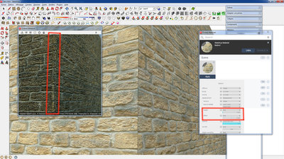

must be put in the displacement offset menu the same height value with the symbol "-" in front.
Example:

Octane displacement doesn't support continuity.
