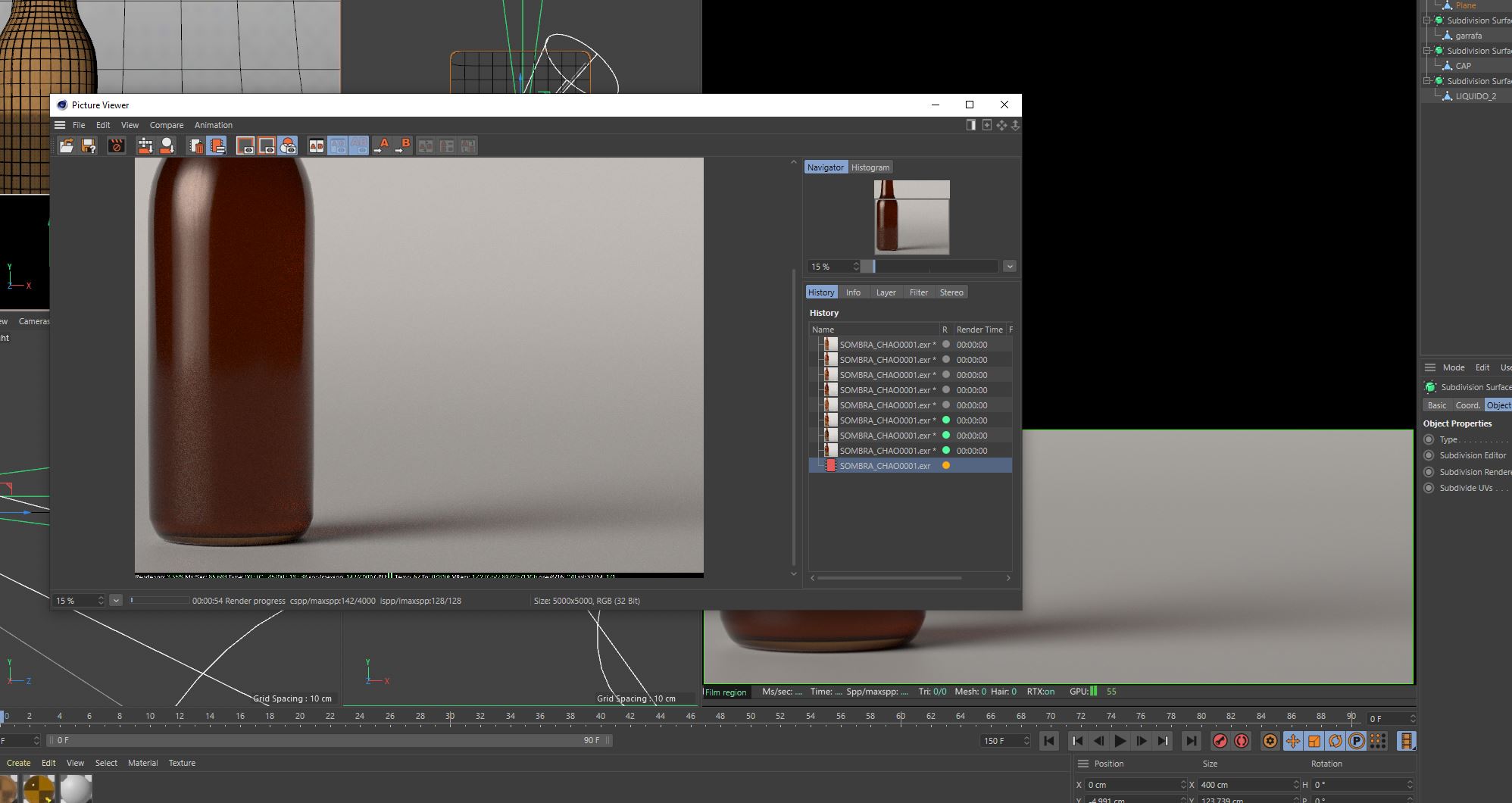

dddavila
Posts: 8
Joined: Wed Sep 14, 2016 11:26 am
Hi guys,
I'm trying to activate render region, following the exact same steps but no success.
Any tips?
I've added a screenshot as well.
Thanks,
Daniel

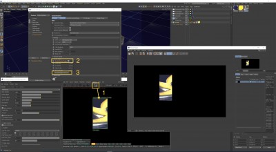

Posts: 10618
Hi Daniel,
which version of plugin are you using exactly?
Render and Film Region rendering in Picture Viewer are working as expected here with 2020.2.1-R3:
ciao Beppe
