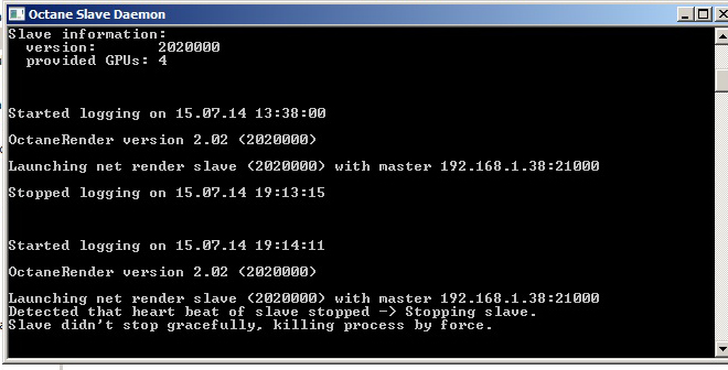

I just lost 16hrs of net rendered samples from 6gpus... (4 network pc's)
Knowing that there was a bug sometimes with *copying to the max buffer and losing samples, I thought I would try and remove each network machine (by unchecking the network rendering tab) one at a time to see if the samples remained before I saved the image.
*lost samples can happen if something thinks the slaves heart beat is stopped.
so...
removed 1st slave. samples remained
removed 2nd slave - samples were removed
removed 3rd slave - samples were removed
gave up and cloned to the max buffer while there was the possibility of keeping remaining slave's 3xgpu samples...
remaining network rendered samples were lost... (obviously a BIG problem).
Error on the slaves: detected that slave's heart beat has stopped. / slave did not stop gracefully.
render size: 8600x6708
vram: 4.9GB
7x6GB gpu's
RAM on master 16gb - using all of it.
should I render through backburner with networked gpu's enabled instead? or commence with the furniture tipping!?
