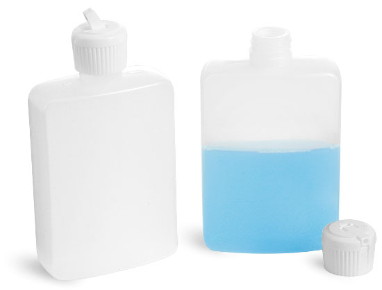

Hmmm... I prefer calling it Physically BASED, not "correct"... after all, Snell's law is not implemented AT ALL (internal reflections etc), and Octane has no clue whether the ray is In the medium or our of it to produce internal reflection to begin with... there is no real absorption either. Anyway, you are probably right about the hsv correspondence, I'll have to look it up, thanks!
EDIT: I posted an image of a white plastic container, see how it's opaque in a way, but still its tone is white! There are some tuppers around my kitchen that can confirm that
