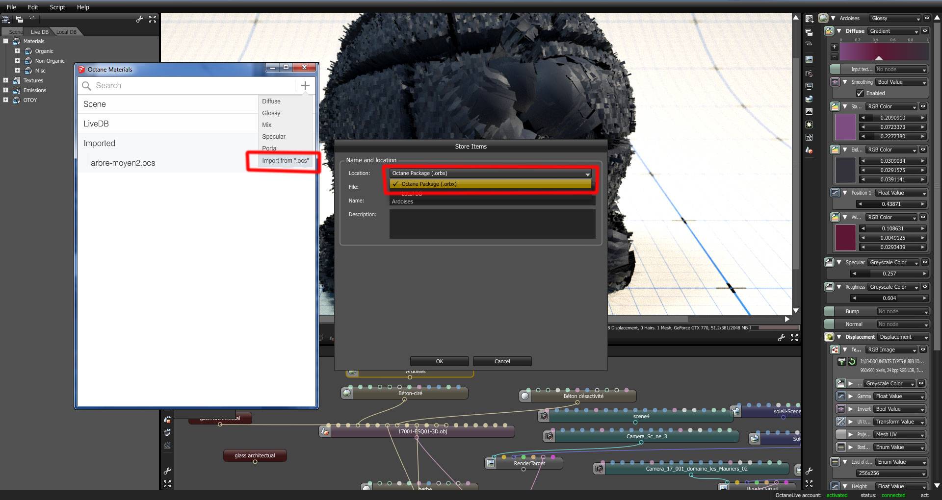

Hi all I have install the latest version 2.03 for octane and OctaneRender SketchUp 0.10.621.
I would like to retrieve the Material from standalone but there is the possibility to record. Ocs. this is the only. Orbx
On OctaneRender for SketchUp can import only ocs.
Could you help me.
THANKS
SAVE .ORBX OR .OCS

Hi Interfaces,Interfaces wrote:Hi all I have install the latest version 2.03 for octane and OctaneRender SketchUp 0.10.621.
Could you help me.
THANKS
Yeah, I think ".orbx" extension is not supported right now, but I'll add the ability in the next build.
As a workaround for now just rename "scene.orbx" to "scene.ocs" and do the import. It will work.
Cheers
UPD:
OK.. I checked that, it doesn't work
