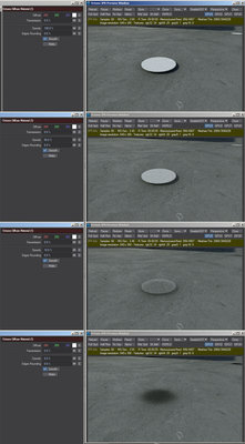

I have a problem with a opacity channel. it has a map to clip de texture, but the shadow continues being kept full... i think that Octane 1.55 it works...
thanks!

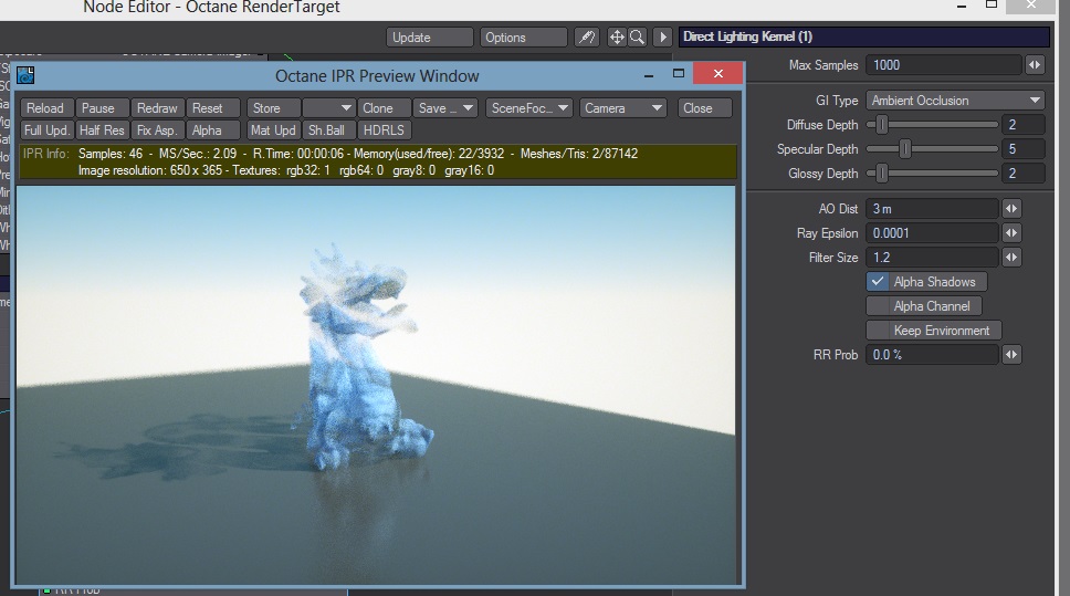

You need to enable the "Alpha shadows" option in the kernel node.

I have enable "Alpha shadows", but its not work.

The direct shadow disappear, are you using also an HDRI environment map? ... I am not sure now if the opacity shadows works with the environment light.

Yes, i am using a HDRI... :(

Nope, this is not the problem, here the HDRI environment shadows also disappear with the opacity parameter. Perhaps it is a shading issue, because you are using for example the dirt node in the floor?
If you want to send to me the scene I could test it here.

Actually, i am using dirt node... that is the problem.
Thanks!!!
