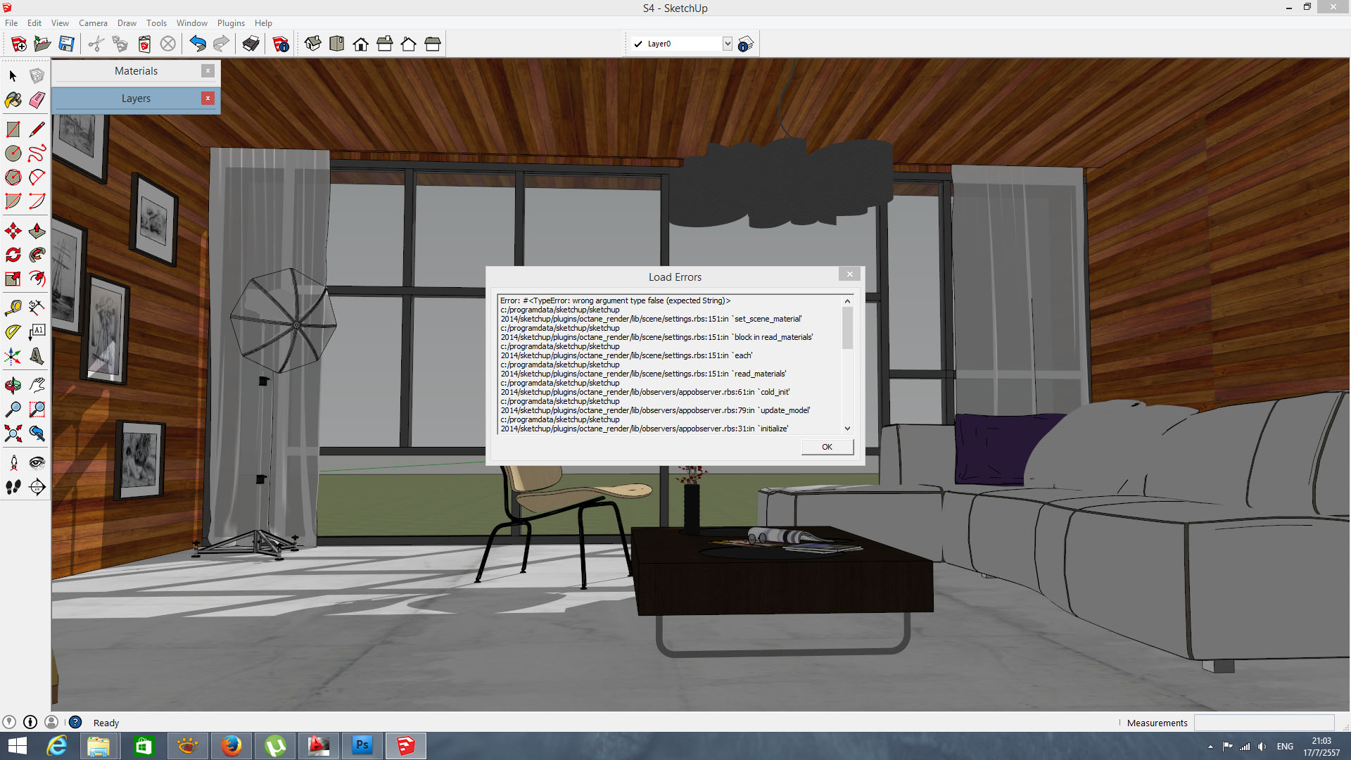

Hi. Octane renders Theam.
When i used Octane4Su. I'm setthing matterail and Render... when finished. I save Project Su File and Close program.
And then i open this project again the program show this Eror. How can i fix it
I'm sorry in my English
thanks.

Hi Bagginsnuke,
Could you please send the scene? It's really hard to tell what is happening without being able to reproduce the issue.

I also got this, but solved when opening su empty document and then open the file.
Hope this helps...

This is really wierd. I've created a scene, applied Octane Materials, did couple of renders and saved the scene. Closed Su2014 and then reopened the scene. Everything worked out smoothly.
Could you please provide the scene that gives this error?

That is really strange I have several projects and all run well.
Did you guys changed computer or changed any directory from you library and project files?

It seems that it's a permission issue (OS win 7). Saved the project to another location and now it's ok.

Dear all,
I also encountered similar errors some times.
I'm not sure, but I think it was when SU materials are configured into Octane, then in a later SU session, deleted from SU model and purged without rendering the model within Octane.
Then when I try to open the SU file again later, Octane outputs this kind of errors.
But did not create a scenario to reproduce.
