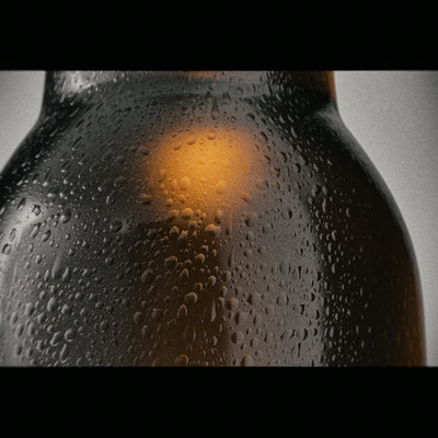

Godstrike, imho, the real/correct way to do water drops is to use real geometry. I personally would make these in ZBrush (though, they could be made in Modeler too - highly recommend using Multiply > Place Mesh), give each drop its own UV island (zb uvmaster makes quick work of this), and bring it in as a separate object (all drops in one object, not separate for each). You have more control over water and having separate uv for water allows for full use of can UV for the can maps. You don't even need to boolean cut the drops. I believe they will look great, even if half of each drop is inside the can geo.
