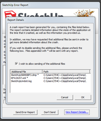

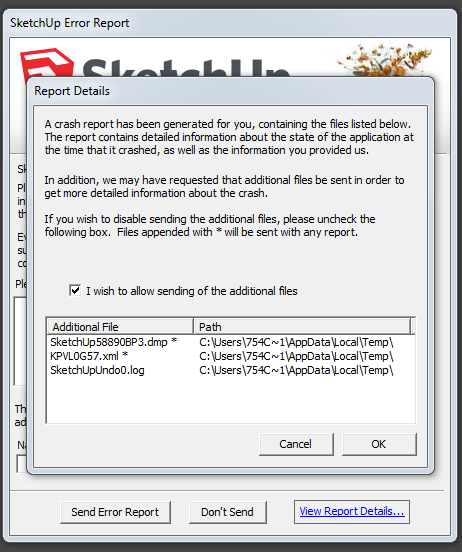

Was interested in Octane 1,5 years for now and decided to buy license for SketchUp plugin after testing of demo for a while. Demo was 10.520.
After installation of 10.621 SU can't start - startup ends with Bugreport window. Tried with 8 Pro and 2014 Make, same result - before installation of Octane Plugin works ok, after Bugreport window and that's it.
Standalone works fine.
Any ideas how to solve this? :oops:

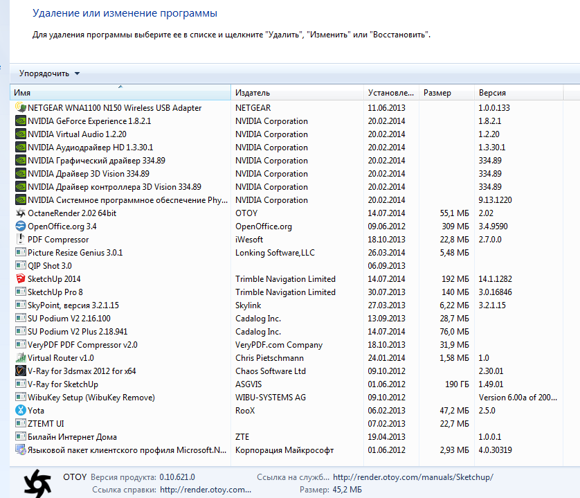

val2k
Posts: 7
Joined: Mon Jul 14, 2014 6:59 am

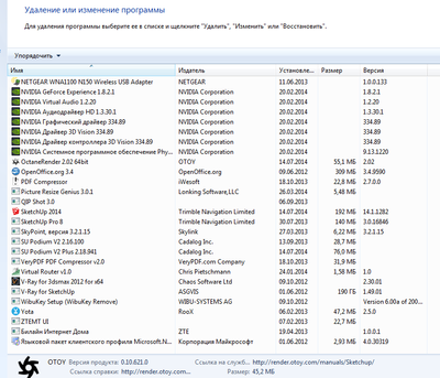

Same story, Bro.
Made uninstall of plugin via control panel:

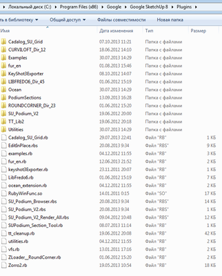

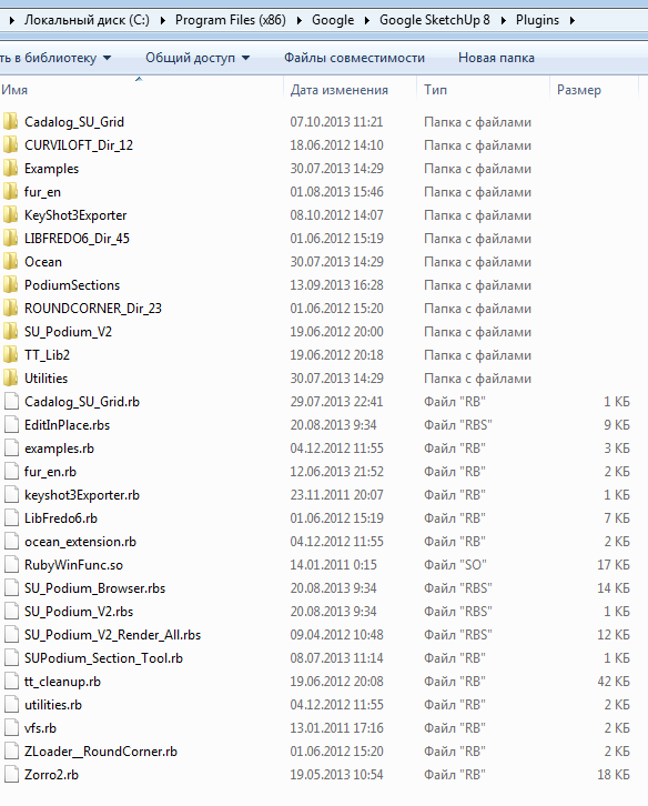

checked for no any octane folders inside Sketchup folders:

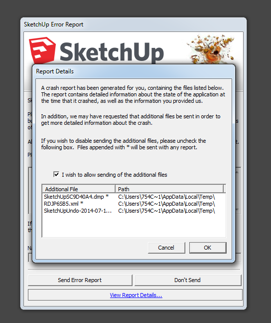

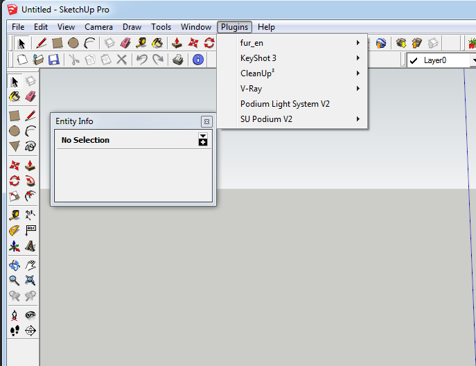

then made reboot, then started SU:
and after made install of plugin from your post, bug splat again:
Tried also with 2014, same result.
