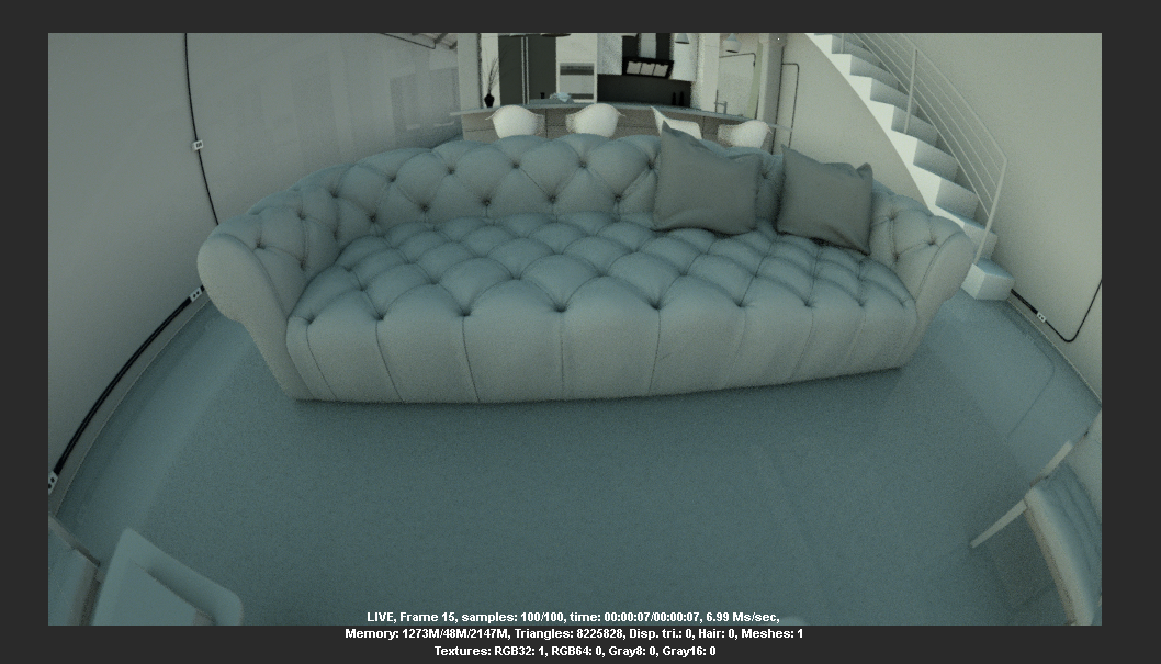

As I said, each frame takes arround 10 sec while navigating in 3d space in the IPR LIVE render.
(See attached rendereing which took 07 sec. REDNER.png) All the convertion before final rendering starts takes about 2-3 Min.

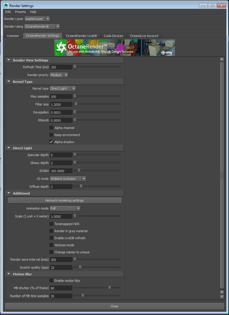

Render Settings: See the attached RENDER.png

Hi Daniel,
If nothing is animated in your scene other than the camera you can set the animation mode setting in the octane render settings to camera only and the scene will only be translated once for the first frame. If you do have animated objects you can set just the animated geometry's geometry type attribute (found on the shape nodes under extra attributes) to movable proxy if the object is just transformed, or reshapable proxy if it is deforming and set the animation mode to movable proxys, then only the animated objects will be re transferred to the GPU per frame. Note that once you have movable proxies sent to the GPU there is a slow down in actual render time but it is usually worth it for animation due to the time saved per frame for translation. The other geometry type scatter is for when you have instances in your scene which do not move during an animation, with this they will only be loaded on the first frame when animation mode is set to movable proxys.

Yes, TBFX have already well explained this: there are two different stages when you render the frame by Octane - translation stage and rendering itself. When you have some complicated scene, translation of the geometry and materials can take a lot of time, even longer than rendering stage. So, perhaps it is what you get here: when you start the IPR, translation takes the same 2 minutes, and then the rendering itself takes 7 seconds. But if you render the sequence of frames by batch render in "Full" animation mode - you get the same 2 minutes plus 7 seconds per every frame. If this is the case - just use TBFX's advice to fine tune your animated scene, and you will get a lot faster rendering.
But if it is not the case, and you get faster translation times in IPR than in batch rendering - then it is perhaps some bug, and in this case I will need more detailed statistics info from you and perhaps the scene itself to be able to reproduce and fix it...
