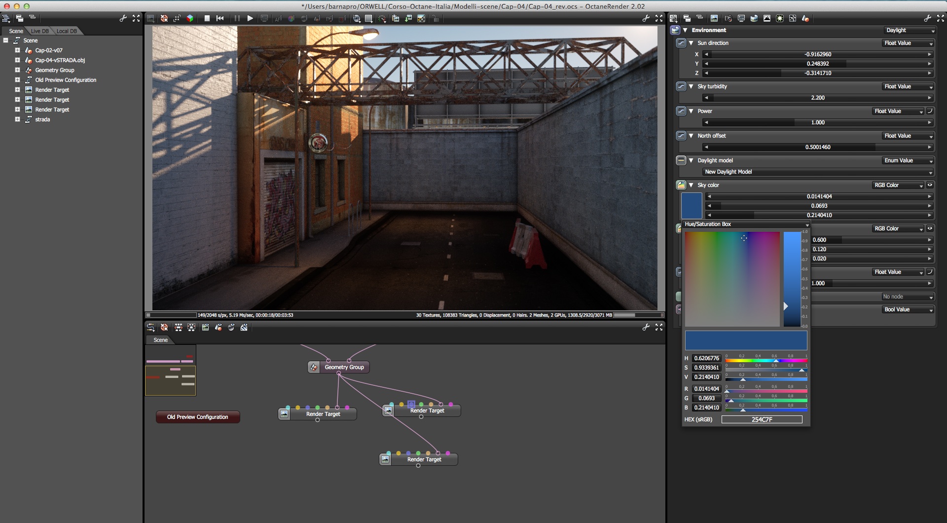

Posts: 10526
hi,
with the physical sun you can play with the sky color that controls the global illumination:
standard sky
standard sky

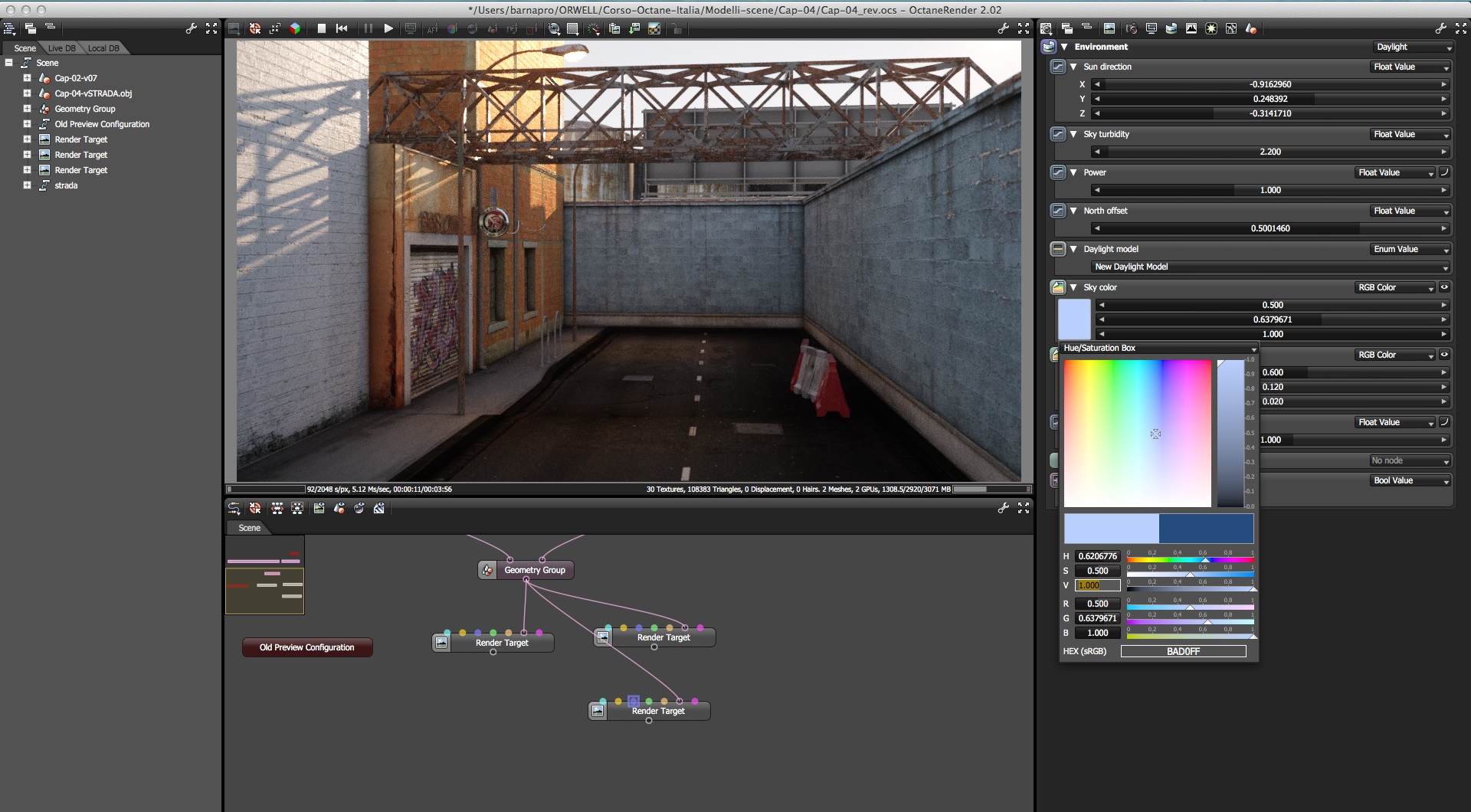

clear sky
clear sky
with other kind of illumination you need a big low power emitter, i think :roll:
