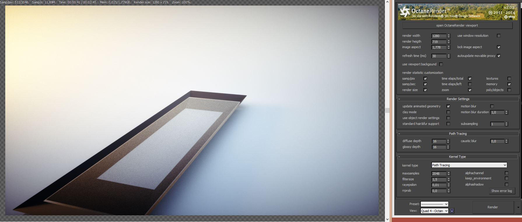

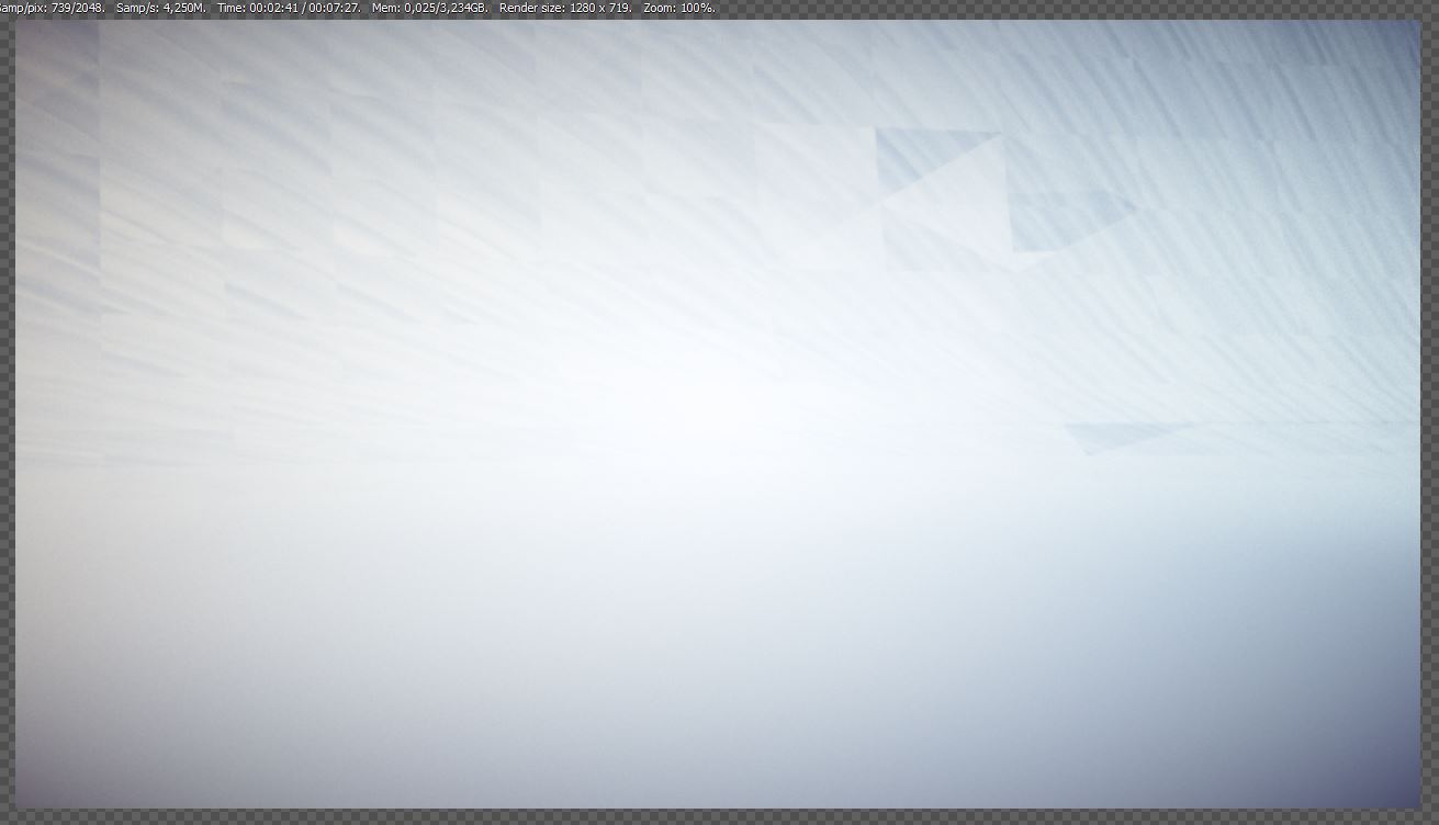

I've strange triangles appear on modelisation like attached file.
It's a simple scene with only plane and two lights..
I've try lots of things, new modelisation did same problem..
DirectLighting / PathTracing / PMC did same problem.
I already try merging in new scene, same problem.
I f anyone have an idea ;)

Somes precisions :
This bug affect all objects in the same place in the scene, like this simple cube
I've delete all lights and recreate other, same problem

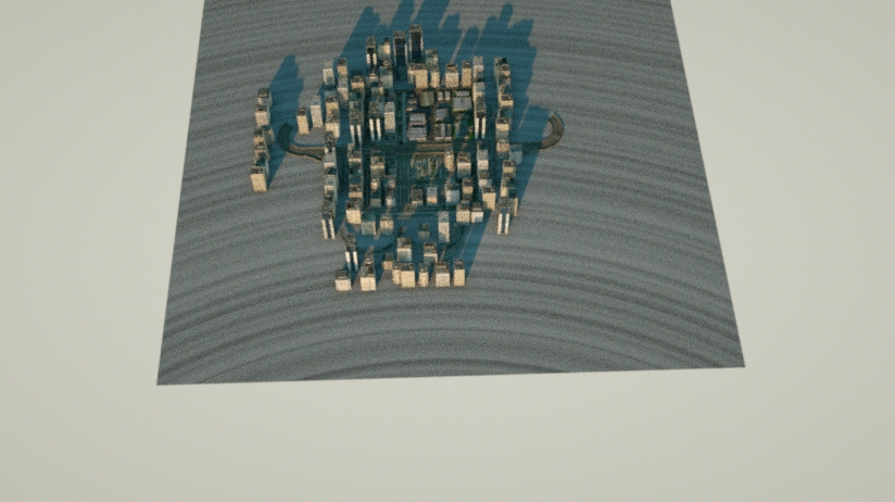

Lol i got the same problem just recently

set ray epsilon to something bigger.

unfortunately i did not i went back to 2.01 because i also had preview scramble bug

Thanks for your reply.
Changing the rayepsilon solve this problem, great thing !
.... But affect problem on specular materials.
You can see in attached :
1 : Rayepilon = 0 -> StrangeBug
2 : Rayepilon = 0.1 -> StrangeBug disseapear, but Specular material have problem on the side
3 : Rayepilon = 0.01 -> StrangeBug disseapear, but Specular material have problem on the side (limited but present)
