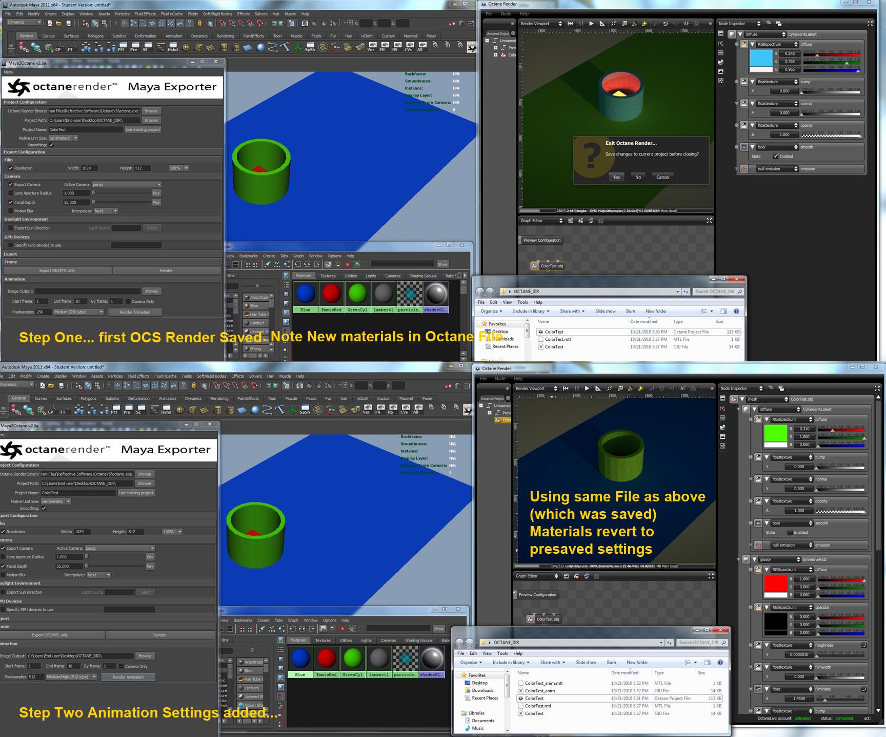

Want to check my work flow. I am creating something in maya Loading the plugin and naming the file and adjusting all the settings as appropriate
Octane launches and I change various materials to emissive and save the file.
Go back to the plugin interface and choose the animation export command with appropriate dir to save the files etc.
Octane loads but none of the emissive qualities or material changes including smoothing are set.
I do not mind doing a command line render if needed but have not had troubles with this working in past.

This may help Bazuka

im checking now and looks like there is a bug in octane ill have to check 1x to make sure i did everything right...
cheers
p.s. i just checked in 3ds max and xsi and i got the same probl like in maya, so i think could be a bug in octane...

Thanks Bazuka. Thats a Bummer. Do you think its something you can work around with the plugin or de we have to wait for the next release of Octane?
Just wondering if I should instal an older version of Octane... go back to 2.3?

Yep... just tried pre2_3.. works like a charm
Good luck. Would love a download even if its a temp fix for v5 Bazuka
