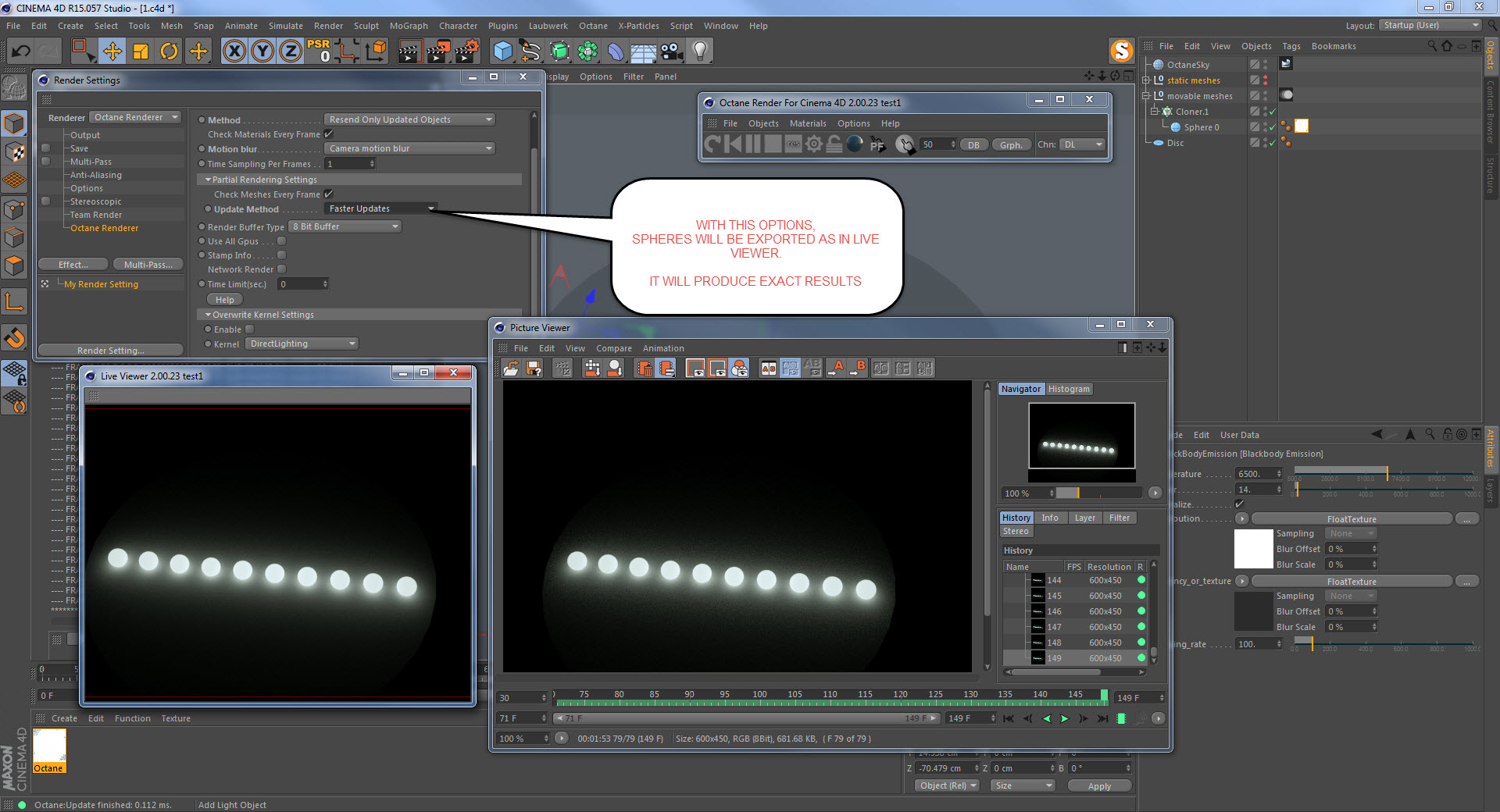

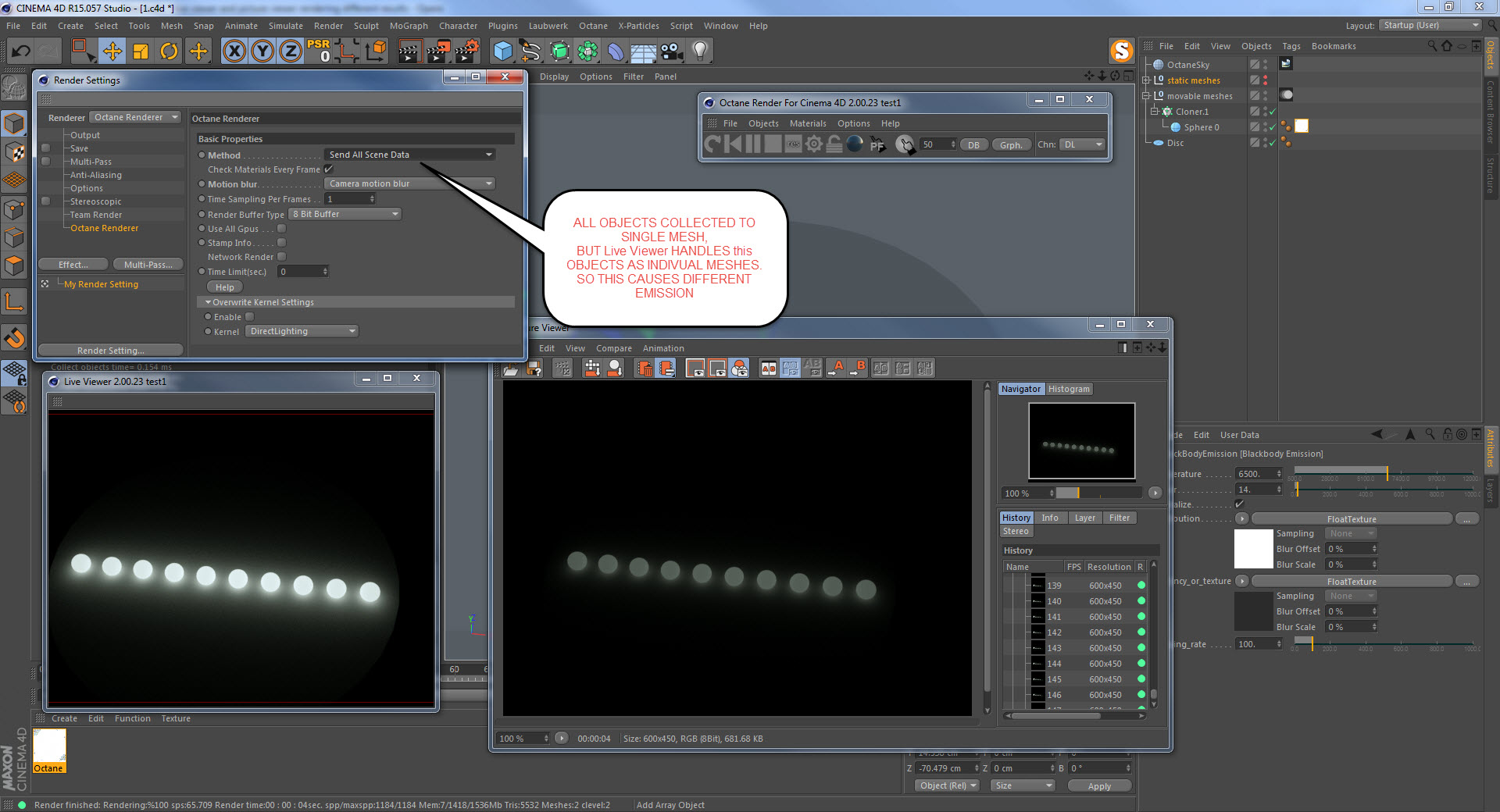

Q7: i'm getting different results in Picture Viewer. It's differing from Live Viewer.
A: If you have arealights or object emissions please set your render settings as matching the Live Viewer system.
change method: Resend only updated objects and Update method: faster updates
Also put a objecttag to emissive geometries. These meshes will be exported as indivual meshes.
This combination is exactly like as Live Viewer(interactive mode)
if you leave the "update method" as faster rendering, all objects in a same object no. They are collected to a single mesh in rendering. This causes different results.

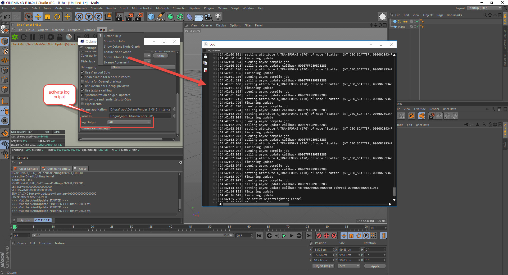

Q14: Generating debug log information
Activate debug output by putting this "octane_log_flags.txt" to location of "Cinema 4D.exe" and run it. Then activate additional log output from settings->others->Log_output. Show a screen like as i attached with informations and plus "octane_log.txt" from Cinema4D folder. Which has log outputs.
To activate log output. Don't forget remove after task completed.

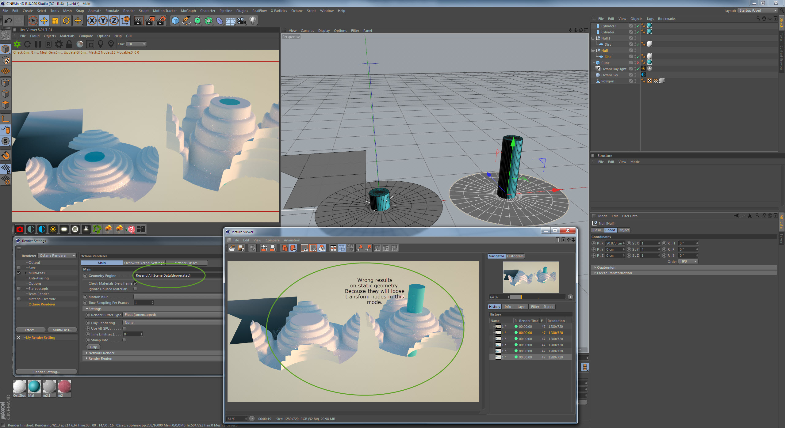

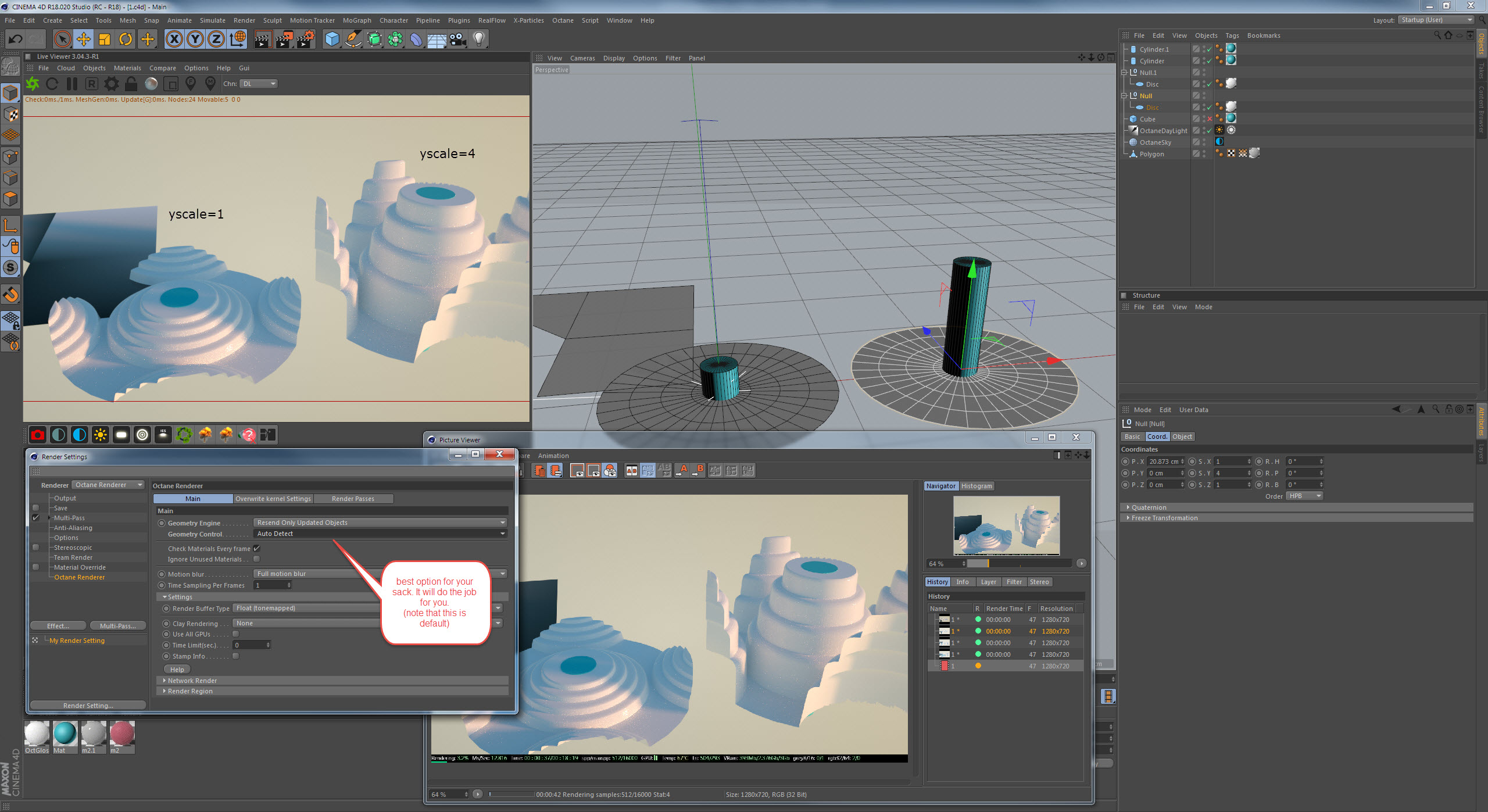

Displacement results are different in Picture Viewer against Live Viewer.
Note that you'll need to use latest updates of plugin and "Auto detect" or "All movable" options. Because Live Viewer is defaultly working with "All movable" option. These are generating indivual meshes with transform nodes. Displacement amount result will be multiplied by scale factor of objects when you use this modes. And this is expected behaviour. Don't try to use "Send all data". It will be deprecated soon.
See picture for comparisons
