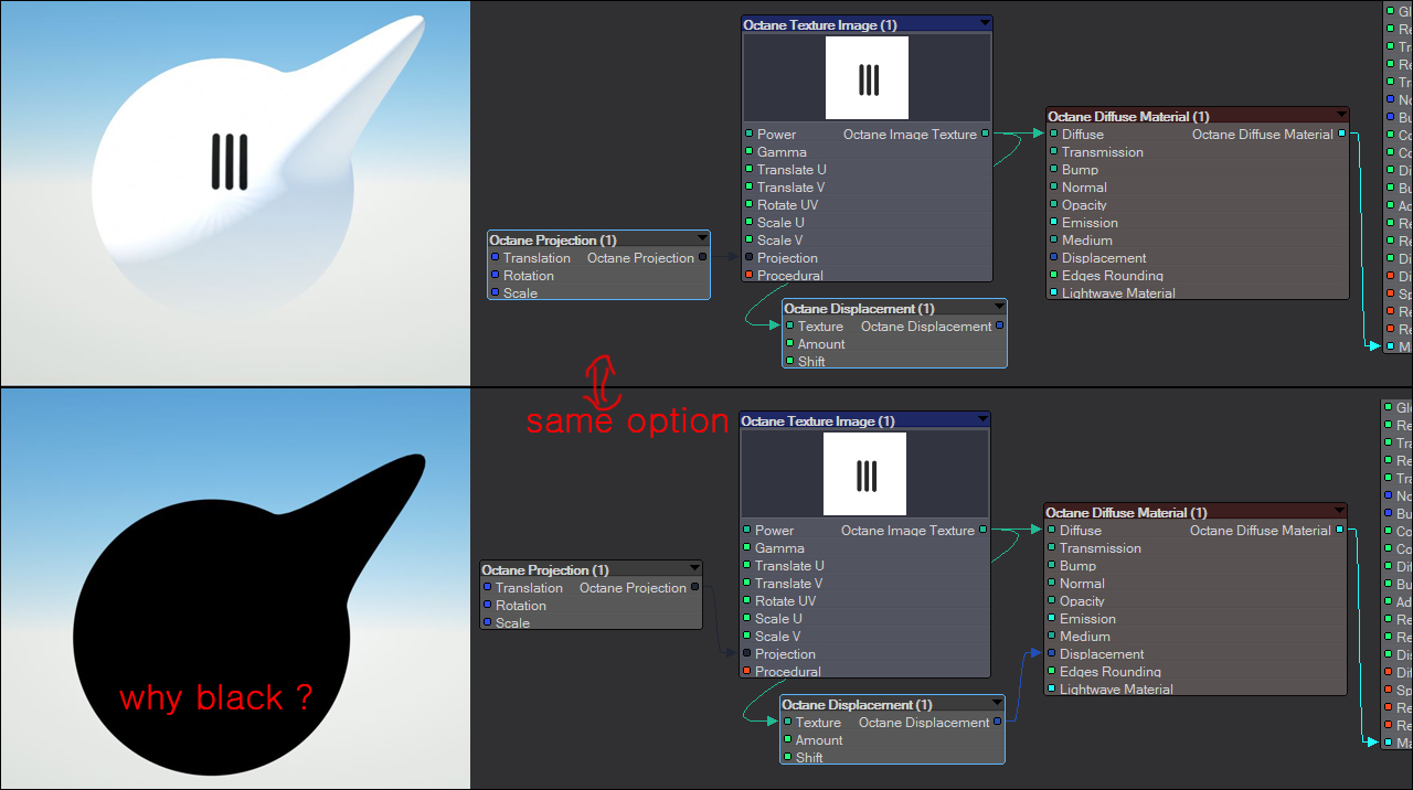

Projection displacement broken.
Moderator: juanjgon
tokkonv
Posts: 17
Joined: Mon May 06, 2013 9:20 am
Check the attachment file please!
i don't know why it's is can't be work.

You need an object with an UV map. Currently displacement mapping doesn't work with the Octane projection node.
