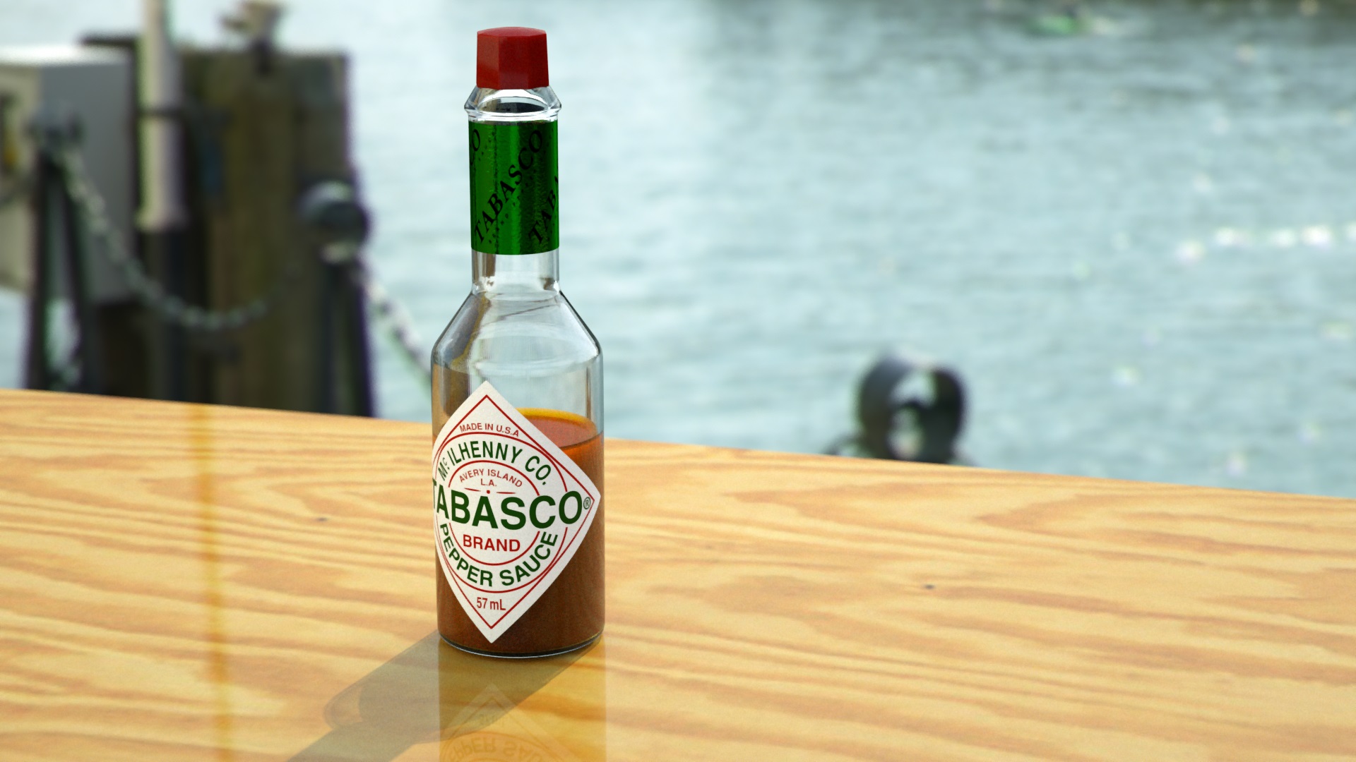

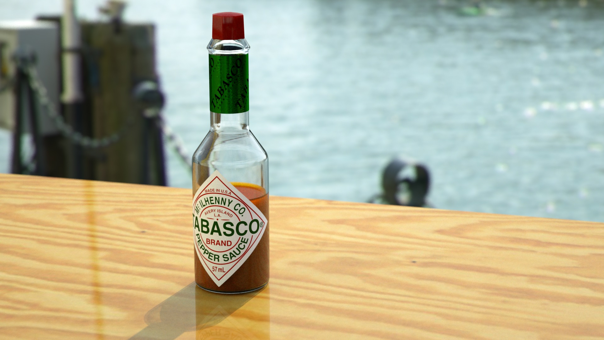

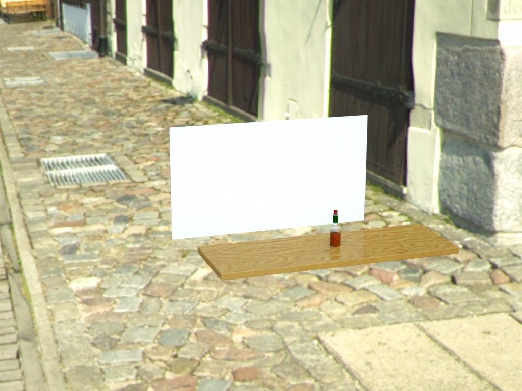

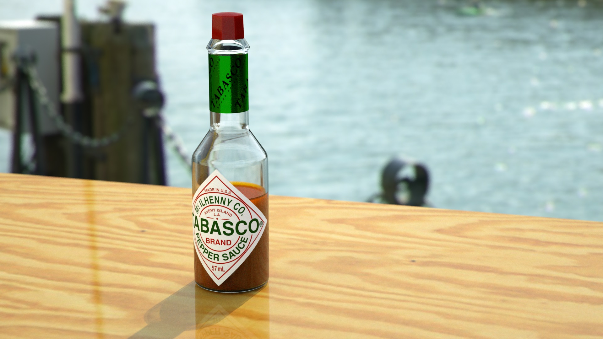

In your case I'm 99% certain the fireflies are being caused by something besides your backplane. It looks like the character is standing on a reflective surface (water?), and the light reflecting back on her from underneath is causing fireflies. Did you try turning off hotpixel removal?
Here is an example of the same scene with and without reflective planes behind the camera (Blender -> Octane Standalone).
With fully reflective plane (perfect mirror): With white diffuse plane (no specularity): With no plane: Reverse angle scene view (diffuse version): You can see there are no fireflies at all (250 s/pixel, path tracing). [Edit] FYI, yes this has an HDRI environment in addition to Daylight, but I get the same result even with the environment set to all black.
