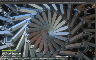

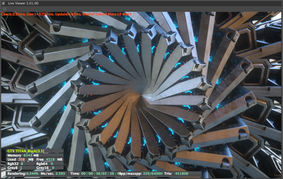

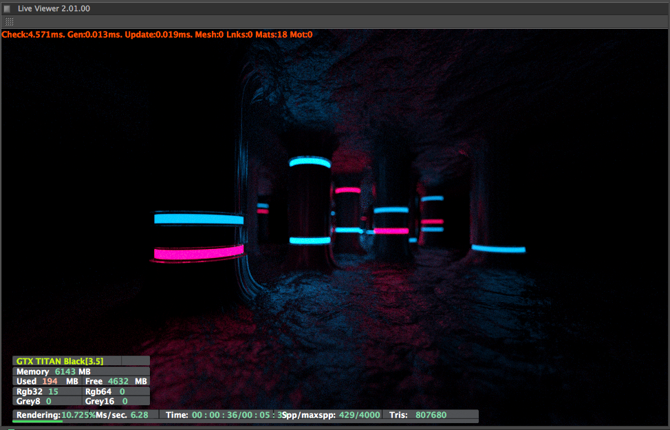

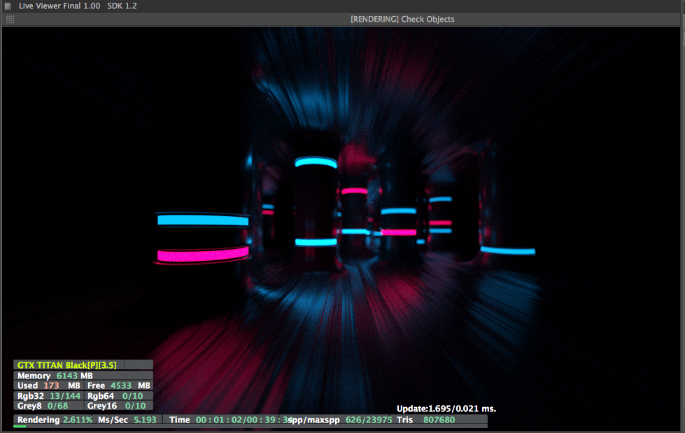

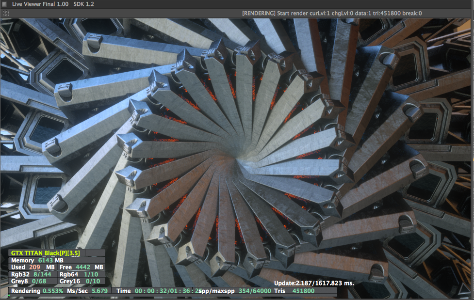

I'm noticing some weird issues going on in V2 that I wasn't seeing in V1. Below i've linked before/after screenshots of two projects from Mike Winkelmann (aka Beeple), and the renders are very different between versions. Whats causing these issues? In the first one, I'm seeing a difference in the texture of the environment/floor. Supposed to be a stretched texture that creates a long streaky effect. In the second one, I'm just seeing incorrect colors for the emissions textures that were applied as well as lighting seems to have drastically changed.
v1 Renders:
v2 Renders:

you need to adopt texture mappings accordingly new nodes of 2.0.
