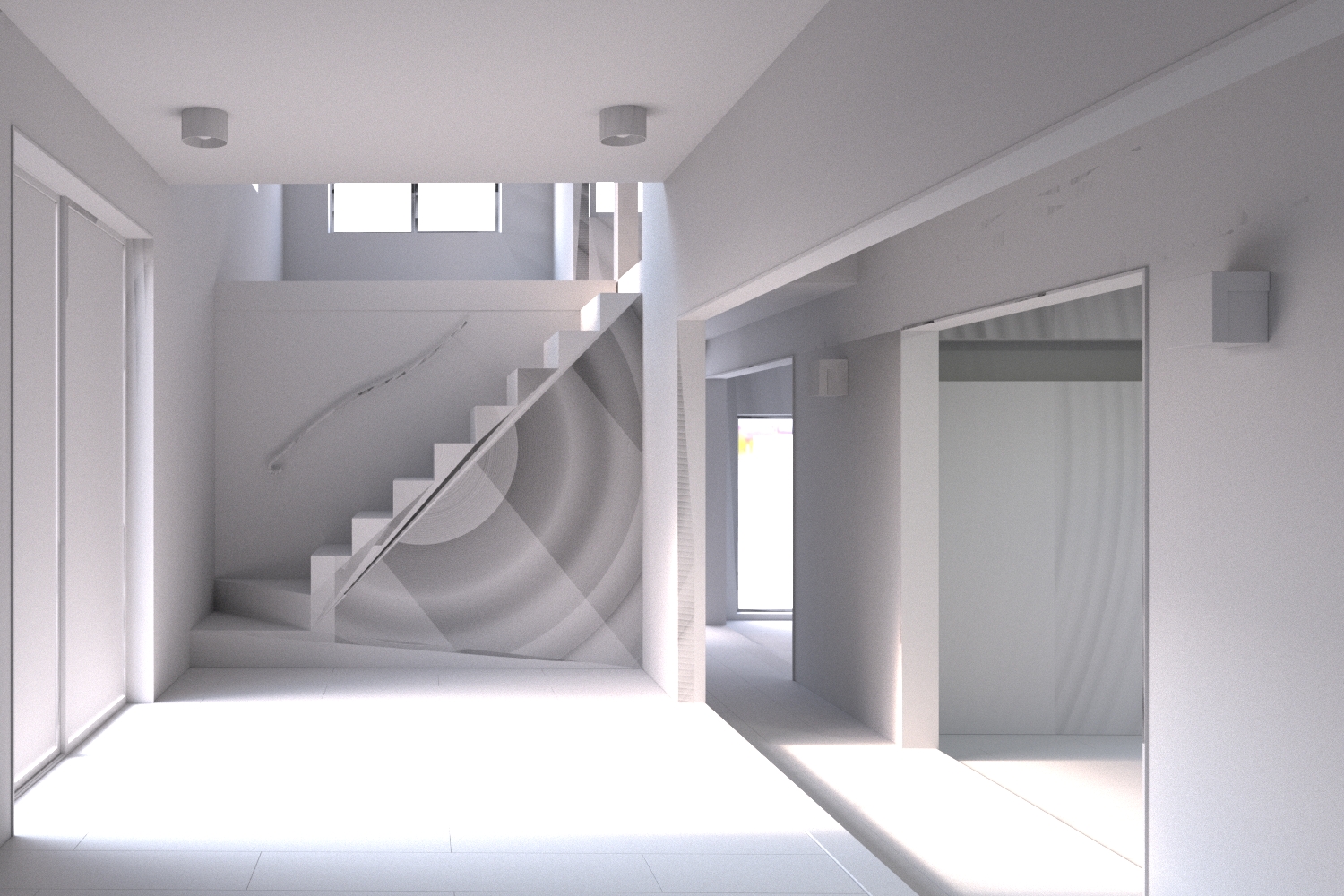

When I move my camera, this bug is appearing and stay.
This is not the first scene where it appears and restarting max doesn't resolve the issue..

looks like that you need to tweak rayepsilon. It's a error treshold factor for floating point calculation. Octane use float point math. So this is not bug

Great, thanks ;)
