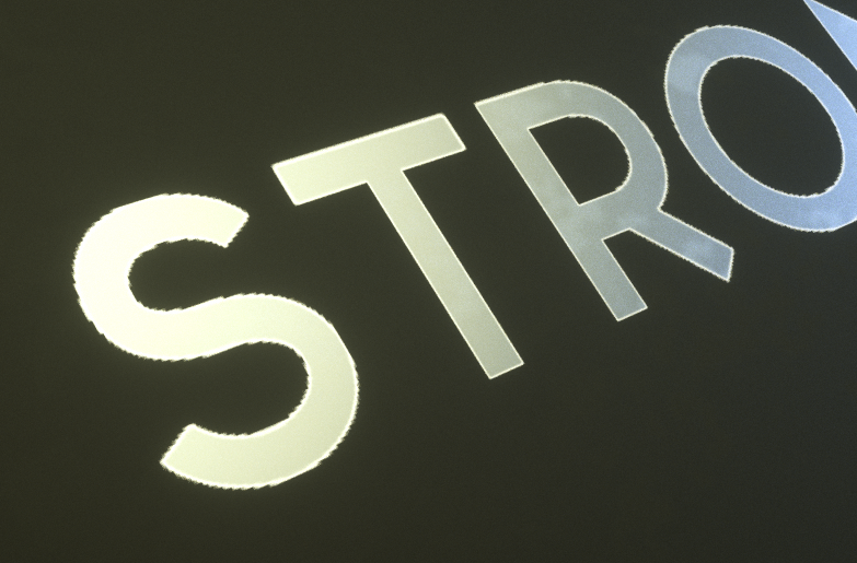

My problem is that when I am importing a text in psd file,
and applying it onto my geometry with the help of a mix material
I am experiencing a black edge around the letters. I have been trying
different data types, and border modes but without success. What am I
missing here?
Luke

Yes I use my text, as PSD file.
In mix material I do use mix texture because i want both materials to be equally - fully - visible.
My PSD file has alpha in it, so I do not use opacity channel because it doesn't seem to be necessary,
i load my text to diffuse channel trough mix material, and then image texture in mix material.
I use smooth AA in PS. It's a little bit complicated to explain this stuff.
You can check out the attached image, to see how the problem occurs - now the edge is white.
Thanks :D

I think the definition of your text isn't high enough. That's the reason of the border i think.
To construct this kind of shader, you only need an alpha bitmap in the amount of a mix material. You just add a glossy and a diffuse material in the mix material. I have made a little sample with a spline text as material for the amount of the mix material but it's the same with a bitmap. Of course, if you need details or different colors in the text, you may add a colored bitmap in diffuse (of the glossy material in this case) ... ;)

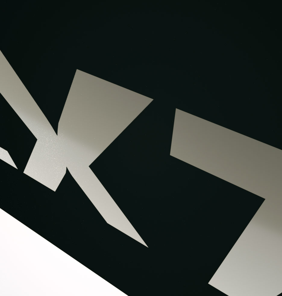

To have a better result with text spline, you should test with Octane settings, Settings tab > Shader to texture set to 1024 or 2048. (This parameter is important for the conversion system integrated to the plugin for C4D shaders like noise or text splines. By default, the setup is too low for a text.)
Or replace the text spline by a bitmap with a higher definition like 1024 or 2048 square pixels. :)
Here a quick render of my sample with shader to texture setting to 4096 x 4096 px
sample with shader to texture 4096px
