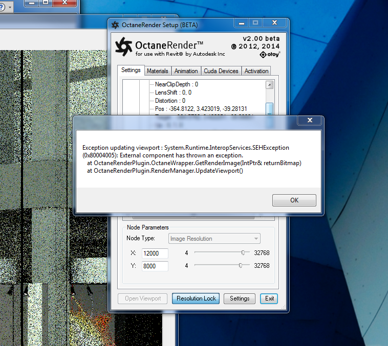

Just got an exception error when raising the resolution to 12000x8000.

Unfortunately I can't near that resolution - because my card is too slow, and the Nvidia driver times out. I suspect either you are running out of VRAM, or the plugin is running out of system RAM allocating the space to refresh the viewport. For renders this size - I suggest exporting to OCS and trying Octane Standalone.

JNDesign wrote: Just got an exception error when raising the resolution to 12000x8000.
drop Your rig specifications down in the signature area =) what hardware You're running.
For that amount of pixels You probably need 3Gb of vRam just to be able to render
(without geometry, textures included =)

I use 4 x titans so plenty of vram, 32gig system ram i7 extreme all water cooled
out of 6 gig
the scene only uses under 3gig
anyways i have dropped my res down to 6000 x 4000 and every thing seems to be fine now.
