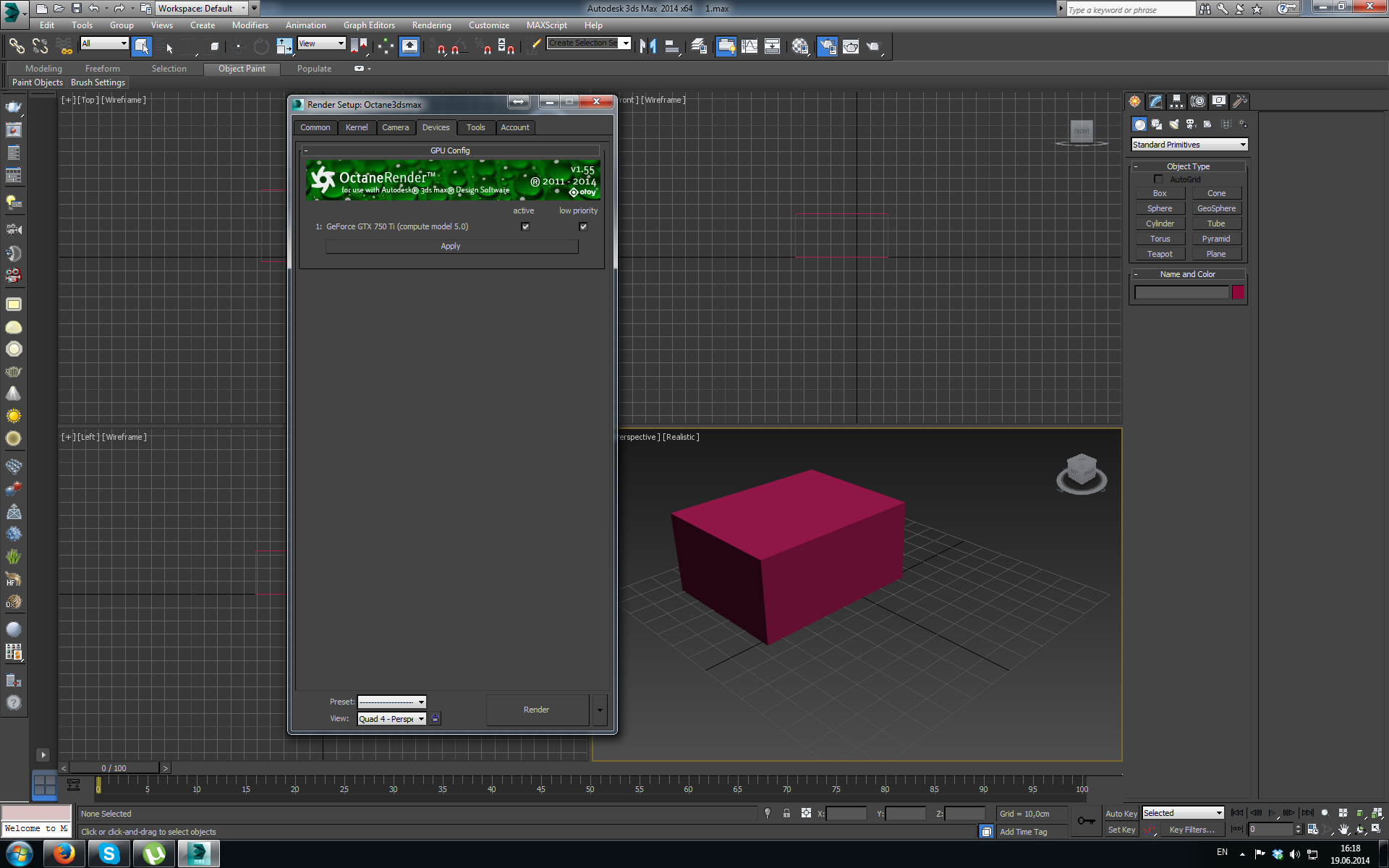

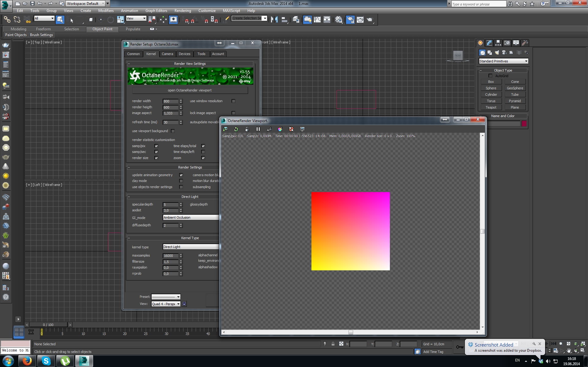

Hello guys, I've just bought new GeForce GTX 750Ti, in Standalone version of Octane it wroks perfectly. But when I use 3ds max plugin it doesnt render anything. It says that there's no memory. What can it be? I've already reinstaled a couple of times plugin and standalone. Havent helped(
Maybe you canhelp?

Hi MiniYeti
Just a guess, try putting a light in the scene.

It could be possible that the plugin version does not support this card yet. I would have assumed that both the standalone version and plugin version would match, and should. It's obviously not a question of graphic driver version since you have working in the standalone version. What about reactivating both plugin/standalone.

MiniYeti wrote:No, didnt help(
Have you installed the latest drivers?
