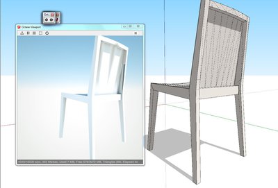

I have a simple chair that I would like to use, but it seems that Octance fails to render the chair :-/
It seems to happen when two curved faces are near each other.
Is there somekind of workaround?
Thanks :-)

hello mate.
Can you send me the chair? it looks like maybe normal are inverted or duplicated mesh.
In StandALone how does it render?
cheers

Jorgensen wrote:Hi
Thanks :-)
Check the normals.
Play with scale.
Let us know if that helps.
Seeker

Hi Jorgensen,
If nothings helps try right-click on the geometry and select "Octane Mesh". In opened dialog select "load normals - false". This will force octane to recalculate normals instead of loading them from SU.
Hope that helps
Bro

hi fuzzybro
thanks - that seems to fix the problem :-)
thank you

Great!
SU can screw geometry up sometimes, so use this trick to fix bad geometry.
Cheers!
