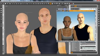

Hi there!
Would someone be so kind as to suggest why my characters' skin/lips are rendering so dark in Octane..? (see attached)
Thanks.
M.

The most common cause I have seen for this (and any other skin texture that comes out too dark in Octane. Looks like her skin is too dark too) is that it picks up a too dark colour in the "power" of the diffuse channel. Check the lips material and see what colour is in the power entry under diffuse. If it is a darker colour, move it closer to pure white (for example up too 230/230/230). That should help.

Oh ho! Yes, the diffuse strength on Scott's lips was set at 45% in DAZ Studio while the rest of his skin was at 100%. Bryn's skin was also set low, but once I bumped it up to 100%, it looked normal in Octane.
Thanks THD777!

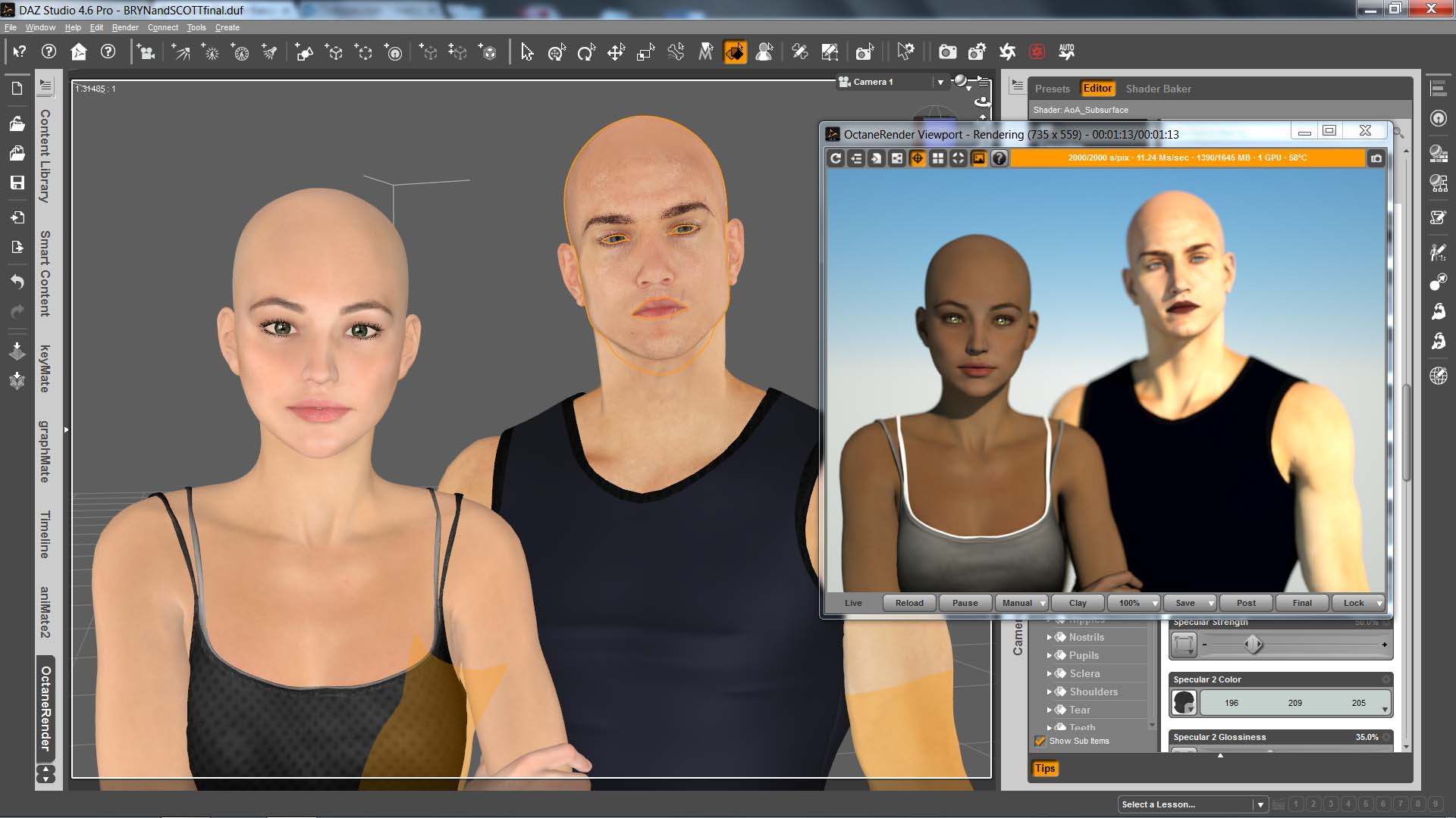

Hey Mellisa. Here some easy basic material settings for skin to start with:
Skin:
Set material to glossy.
Keep Specular at 1
Set Roughness power to about 0.30
Set Bumb power to about 0.125
Lips, inner mouth, gums, teeth, tongue, nails, sclera:
Same as above but keep the Roughness low. Like under .1
Eyes:
As above, but with minimal roughness and minimal or no bump. Index: 1.5. You can try setting the cornea to specular (turn opactity on in both DS and Octane!) with again a low Roughness and index 1.5.
This will give you a good starting point for most skins. Next tweak as you will.

Perfect! Your advice works for arranging the skin, now, what can I do to fix the eyes?thd777 wrote:The most common cause I have seen for this (and any other skin texture that comes out too dark in Octane. Looks like her skin is too dark too) is that it picks up a too dark colour in the "power" of the diffuse channel. Check the lips material and see what colour is in the power entry under diffuse. If it is a darker colour, move it closer to pure white (for example up too 230/230/230). That should help.
