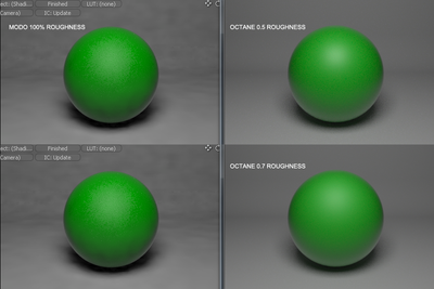

OK I know I said I was doing other things, but decided to fire up some quick tests
Multiplying roughness by 0.5 seems to match less the higher we go. Octane's (or modo's??) roughness is not linear, so I'm not sure how you would get a perfect match
eg. When you have 80-100% modo roughness a closer match is:
octane roughness = modo roughness * 0.7

Let's just keep it simple for now
octane roughness = modo roughness * 0.6
It's not perfect but matches high and low values close enough. It's better than what we already have.
