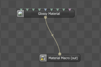

To create a material macro, you can rightclick in the graph editor.
Choose Add -> Materials -> Material Macro.

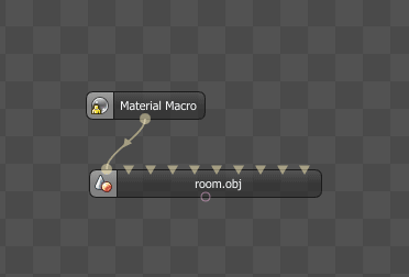

The output from the macro should plugged in the Materialslot of you mesh.
After that, you can double click on the macro to open it.
In the Material macro out you can plug any material you want.

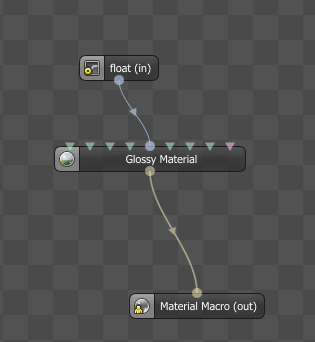

If you want to controll some parameters from outside, you can put a input pin on the parameter you want.
For that you choos Add -> Input Pins -> Input Type (bool, float, int, texture)

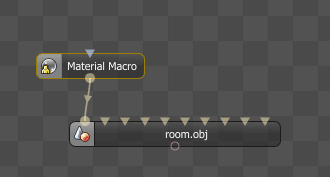

To go back, click at the bottom in your graph editor window on your project (default unnamed project)
After that you will see you material macro with a input pin.
