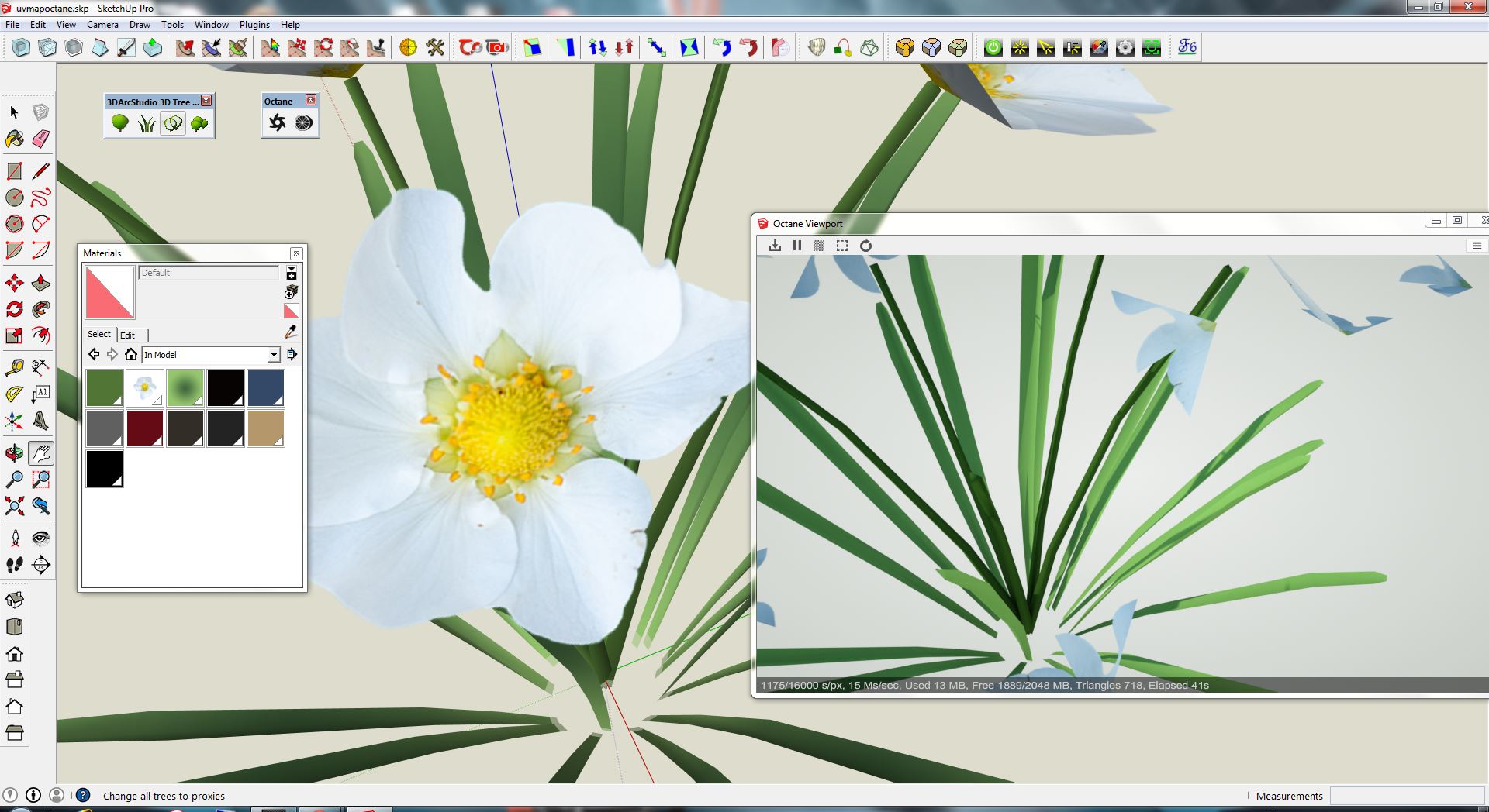

Attached is skp file to test.
Looks like mapping of texture does not work in all cases.
Yours
Pascal
uvmapoctane.zip
skp file
(305.89 KiB) Downloaded 263 times

ppoublan wrote:Hi,
Yours
Pascal
Thanks Pascal! I'll check that shortly and report back.

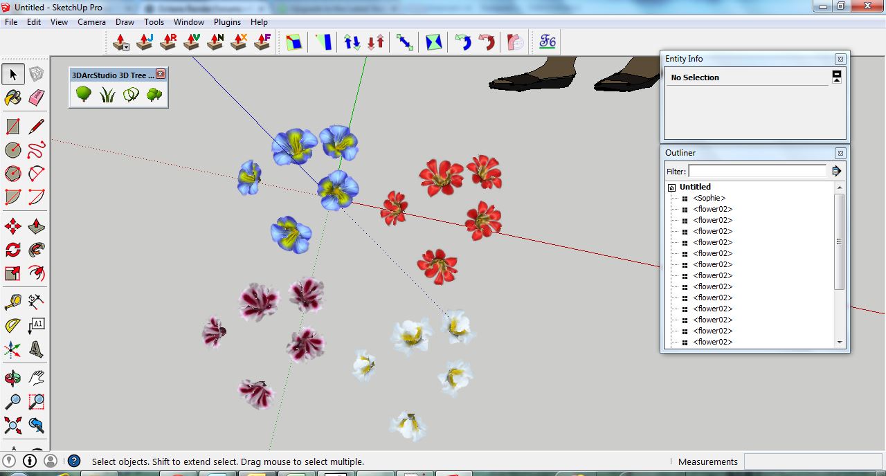

Just want to add some explanation why it would be useful to keep UV Map of faces that are inside components/groups and do not have texture applied (texture is applied to the comp only).
This way you can have multiple instances of the same component with different textures applied on top of the componenent. If not, you have to make each component unique, to be able to apply texture at the face level within the component.
Here is an example with only one component and 4 textures applied to the components.
Yours
Pascal

fuzzybro
Posts: 562
Joined: Mon Jun 03, 2013 7:10 am
Location: Los Angeles, California
ppoublan wrote:Hi Fuzzi
Yours
Pascal
PS1 : sorry for all those questions, but I'm so enthousiast, cant wait to use this amazing integrated render into SU.
PS2 : did not check all other renders, but those I have tested (Thea and Twilight) does not support it (same error), but it may be a "plus" for Octane.
Hi mate!
Thanks for putting time into this!
I haven't checked the issue yet (I'll check it soon) but I can tell that if you have multiple Component with different textures Octane won't treat them as unique components, they are still going to be instances of one definition with different textures. Octane4SU is really flexible in regards of instancing and saves you a lot of memory.
Cheers!
